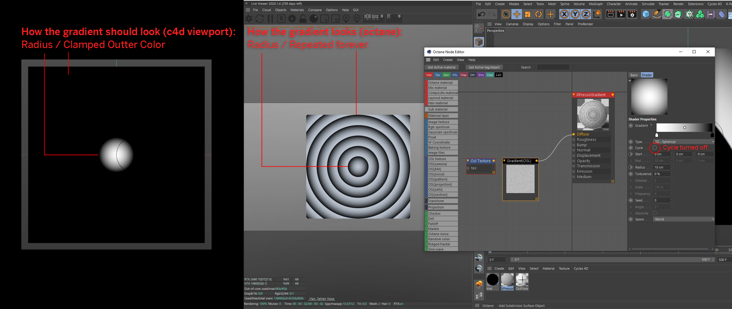

Hey @aoktar or anyone else in this forum,
I am finally trying to solve a problem I had for a long time. I was trying to reveal a specific spherical area of a model via texture. Tried with Dirt node, Vertex Maps and Texture projections, but the easiest and most performant way would be a 3D spherical gradient with Start and Radius Parameters linked to a XPresso Tag.
Doing this with c4d shaders is no problem, but octane renders gradients continuous/repeating, no matter which kind of gradient I use. I tried with Gradient(OSL), Octane Gradient and an actual OSL Gradient node. I attached an Image, to describe my problem better.
I just want to use a gradient, where the outter color is clamped, not repeated. The problem also exist with any kind of gradient, not only 3D spherical gradient. Maybe you guys can fix it, or give me a hint for a workaround.

it's using layer.osl for emulation. Check this revised script
grad1.rar
(107.02 KiB) Downloaded 288 times

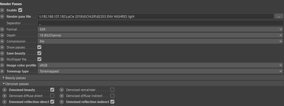

I'm having an issue with EXR outputs in Cinema 4d on this latest update, and don't think its user error on my end. With this most recent version, even though I have the output set for 16-bit tonemapped, my output file is a 32bit linear file.

ndreimi wrote:I'm having an issue with EXR outputs in Cinema 4d on this latest update, and don't think its user error on my end. With this most recent version, even though I have the output set for 16-bit tonemapped, my output file is a 32bit linear file.
It means that's not supported if it's not working. Please use octane-exr type

It did seem to be supported until this last build, which is why I wasn't sure if it was just a bug or if something had changed. Is there any way to output a 16-bit EXR now?

ndreimi wrote:It did seem to be supported until this last build, which is why I wasn't sure if it was just a bug or if something had changed. Is there any way to output a 16-bit EXR now?
which build you mean that was working? Checked on some old version.
Also what's your C4D/OS?

2020.1.3 was working to render out a 16-bit, tonemapped RGB EXR file. It seemed updating to 2020.1.4 stopped that functionality.

ndreimi wrote:2020.1.3 was working to render out a 16-bit, tonemapped RGB EXR file. It seemed updating to 2020.1.4 stopped that functionality.
Tested and I don't see any differences. Saving is based on C4D's functions for this EXR type. We rely to C4D version for that.
