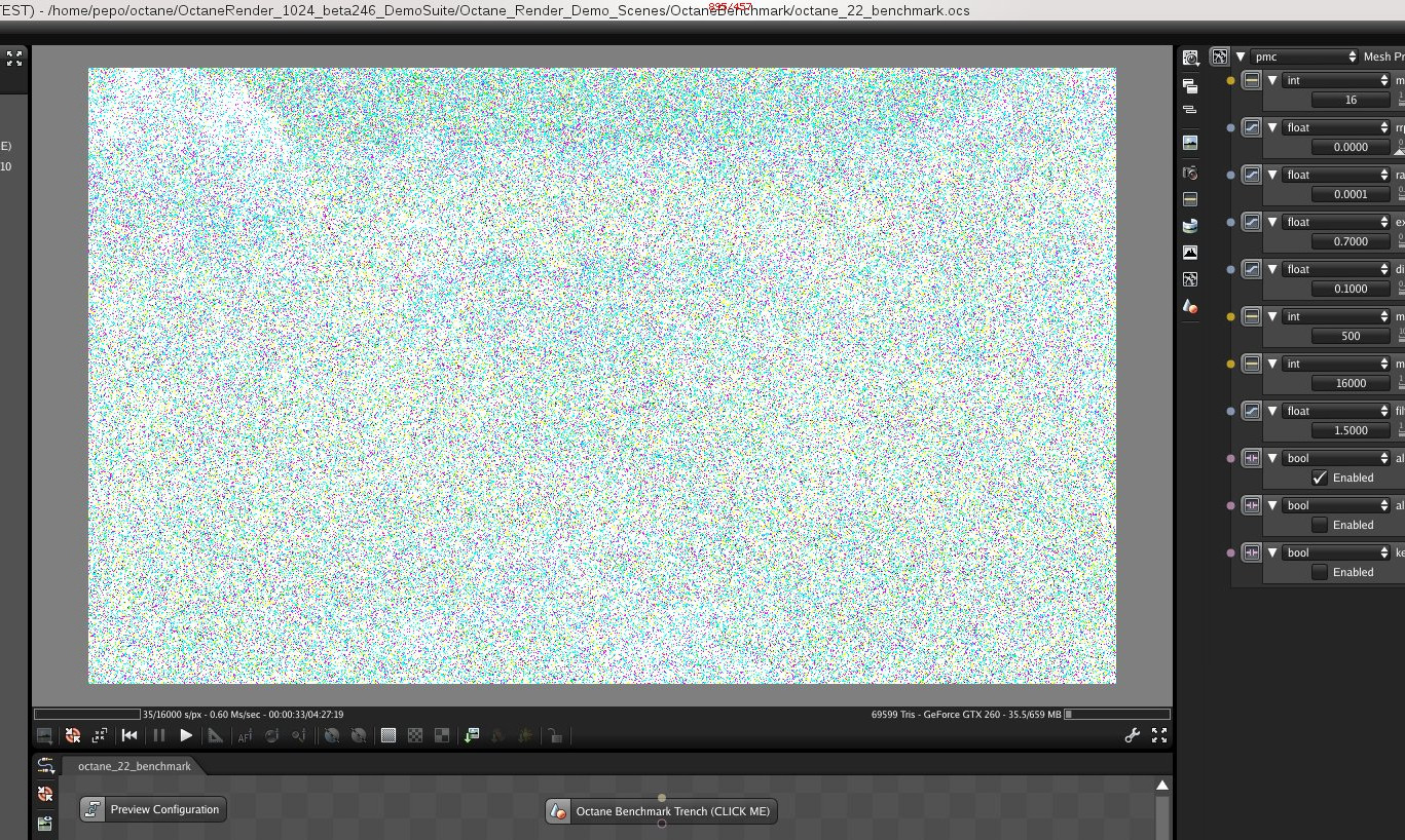

And i am still no able to render in PMC mode on my system.
Tested with the Render Suite Files, the screen goes brighter and brighter until white/yellow.
Cheers, mib.
What do you mean with "expanding materials in "Current Mesh""?
Regarding PMC: Which scene of the demo scenes caused this effect? Could you please post a screenshot?

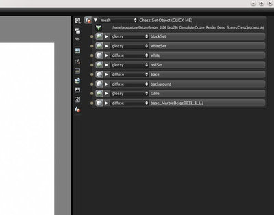

Hi abstrax, it is indifferent which scene i use, this sreenshot is the benchmark scene.
But it is the same with every scene from demo suite or own scenes.
I meant the expanding and collapsing materials.
If you colapse all materials, like in screenshot, and change on material setting all materials expand again.
Cheers, mib.

mib2berlin wrote:...And i am still no able to render in PMC mode on my system.
Cheers, mib.
Have the same issue on Linux, try to set the maxsamples from 16 to 7, this works mostly for me on Linux...
