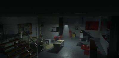

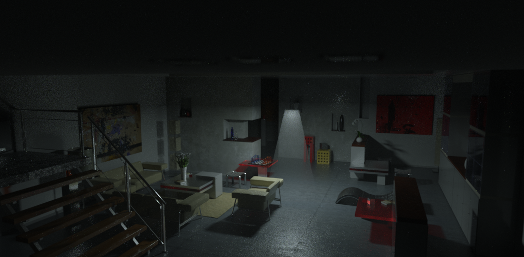

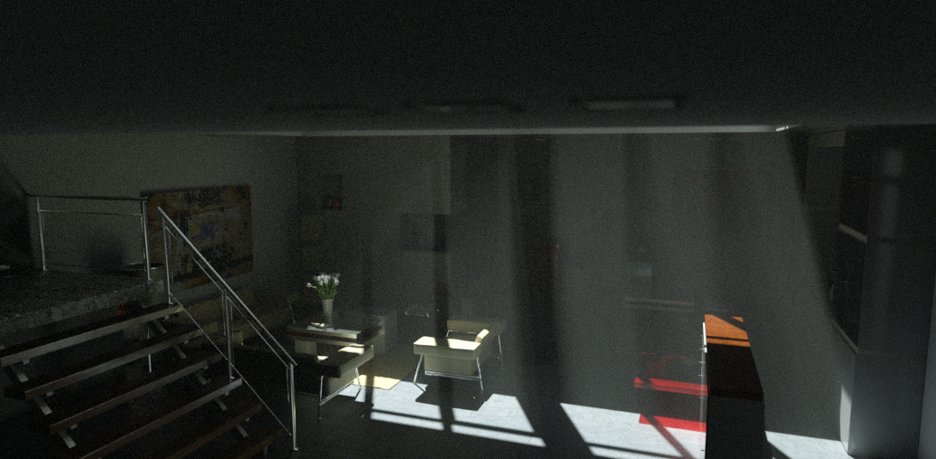

Interior->Daylight->Medium->godrays + Volumetric_Spotlight =
Daylight only:
Spotlight only:

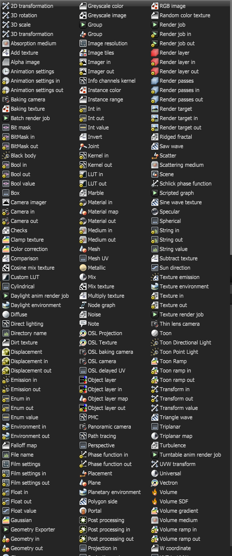

I can't find Volumetric light node in node list.
it has not added to 2018 XB1 yet?

Daylight only:
The attachment godrays_sunpng.png is no longer available

Thank you, these look great. is there any control of fall off?

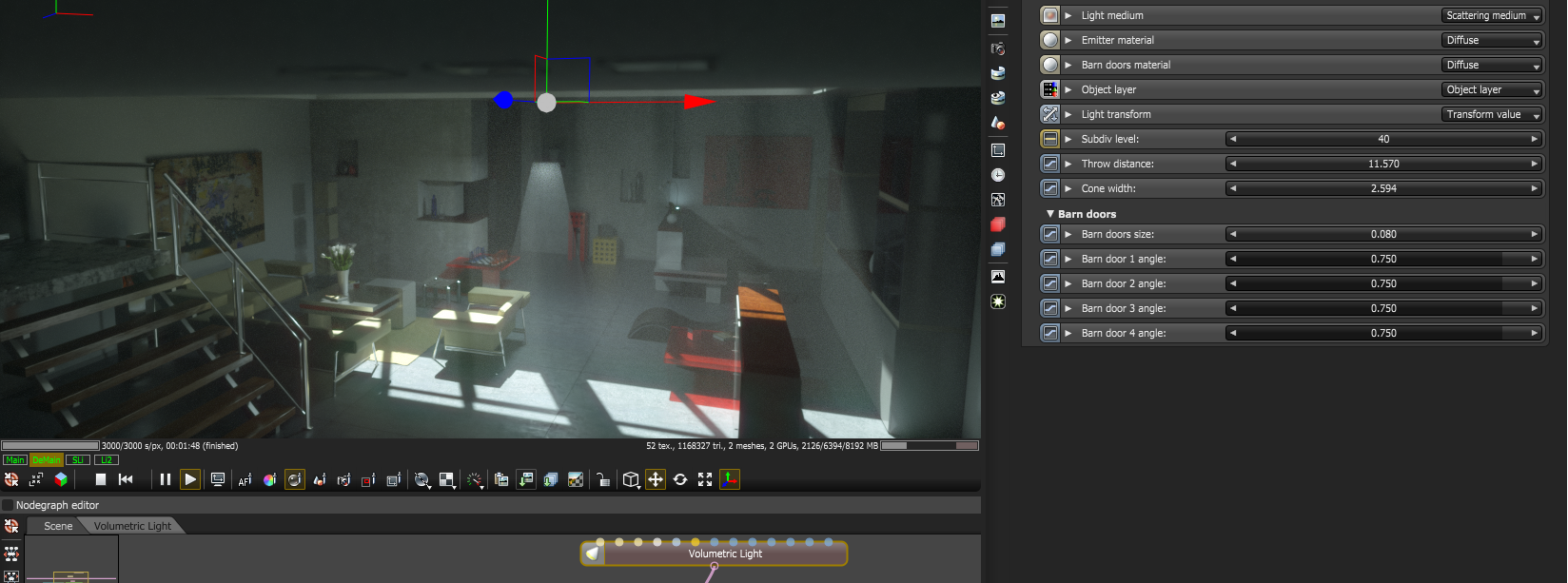

The throw distance is what I was using the shape the light above the way I wanted (mixed with scale and cone size). You can also adjust the medium within an individual light volume rather than sharing the same global medium settings across all lights and the environment.
The volumetric light nodes don’t show up in the node list in XB1, but this should be fixed in XB2.

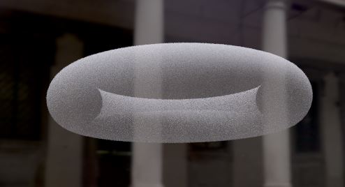

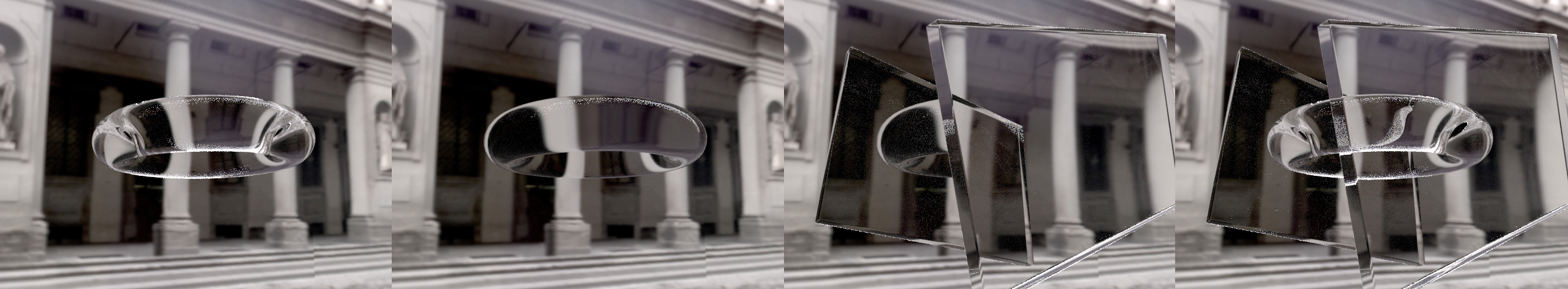

This is not about hiding back facing polygons. It's about hiding the semi-transparent front facing polygons that are seen through other semi-transparent front-facing polygons. And, at the same time, without hiding polygons of other objects.
Using raytype() in opacity we can hide an object from refractions, including its own refractions, but then that object is invisible behind glass. So, that trick can only be used for a limited number of cases and I'm pretty sure, not that many people are even aware that this can be done in Octane.
RaytypeAndRefraction.orbx
(2.6 MiB) Downloaded 270 times
So far I couldn't find a way to hide those overlapping polygons on a per object basis yet in Octane. So, my question is simple: Spectrons?
