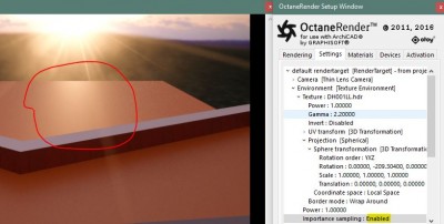

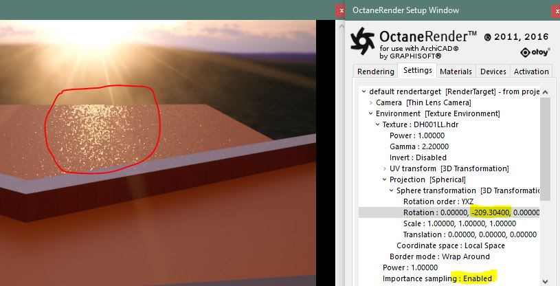

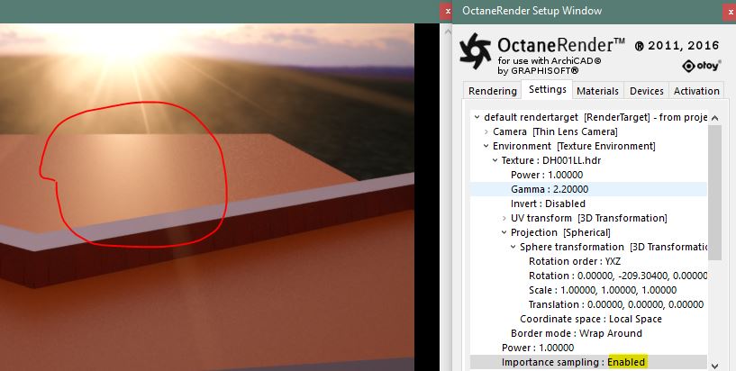

I have to report a bug.
If I change the Y-Rotation of a Texture-Environment, than I have problems with importance-sampling, it misses suddenly the setting "behind the curtain". The importance sampling is on, but it seems to be not.
If I check the importance sampling out and on again, than everything will be fine again untill I change the Y-Rotation.
David
Hi David - this is fixed in the next Octane release.

I noticed the same thing, thought I was going a bit mad.
