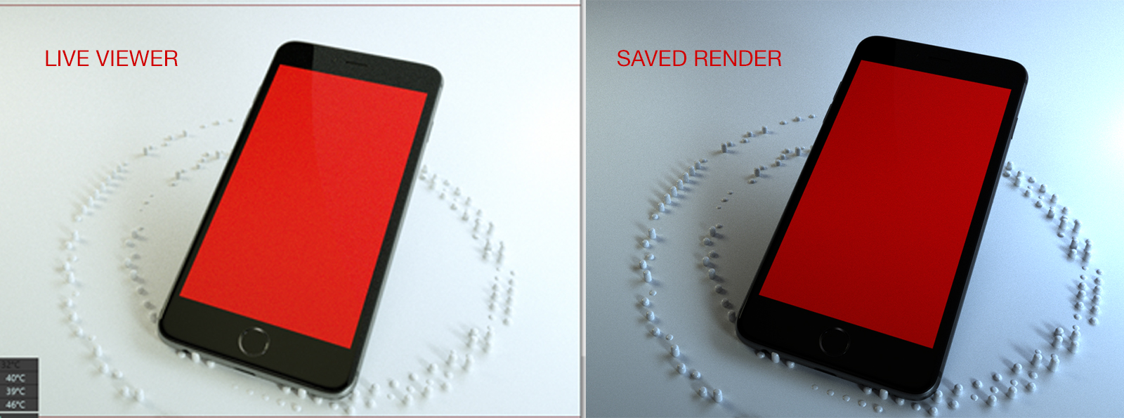

Hi aoktar,
i have a question, i made the update to 2.25 for C4D and since then my renders are coming out too dark.
In my preview render window everything is fine but when i send it to the picture viewer to render it out as a file it is way darker.
What could be the reason for it? Or is it a bug? Its a gamma issue i guess. But i think i made all settings correct. except i miss something.
Hope you can help.
Thanks so much

Posts: 5
Joined: Mon Mar 30, 2015 5:18 am
Hi aoktar,
Hope you can help.
Thanks so much
Tommy
Posts: 10609
Hi Tommy,
what was the previous version?
could you share a simple scene that shows the effect?
ciao beppe
najighassan
Posts: 5
hi beppe,
thanks for your reply.
i attached a image with both renders, its weird it literally just happened with the latest update.
hope you can help.
