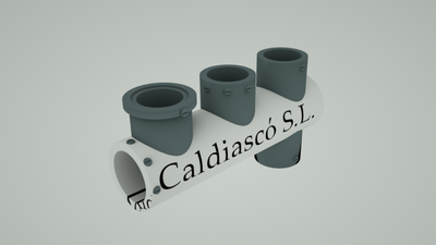

Hi Sam, I had to put a random image fortesting (you didn't put the source image in the zip), but with my WIP addon I have the same result in 2.49 viewport, 2.56 viewport and octane render after export from 2.56.
When rewriting the code I noticed that the texture export was not working as expected and it looks like I've already fixed that, without touching the UVs...
Unfortunately, a couple of issues prevent me from releasing this version at the moment. May be tonight or tomorrow...

Here's what I get straight out of the box, with coloroured clay rendering... I think you're going to push me for getting my latest script
