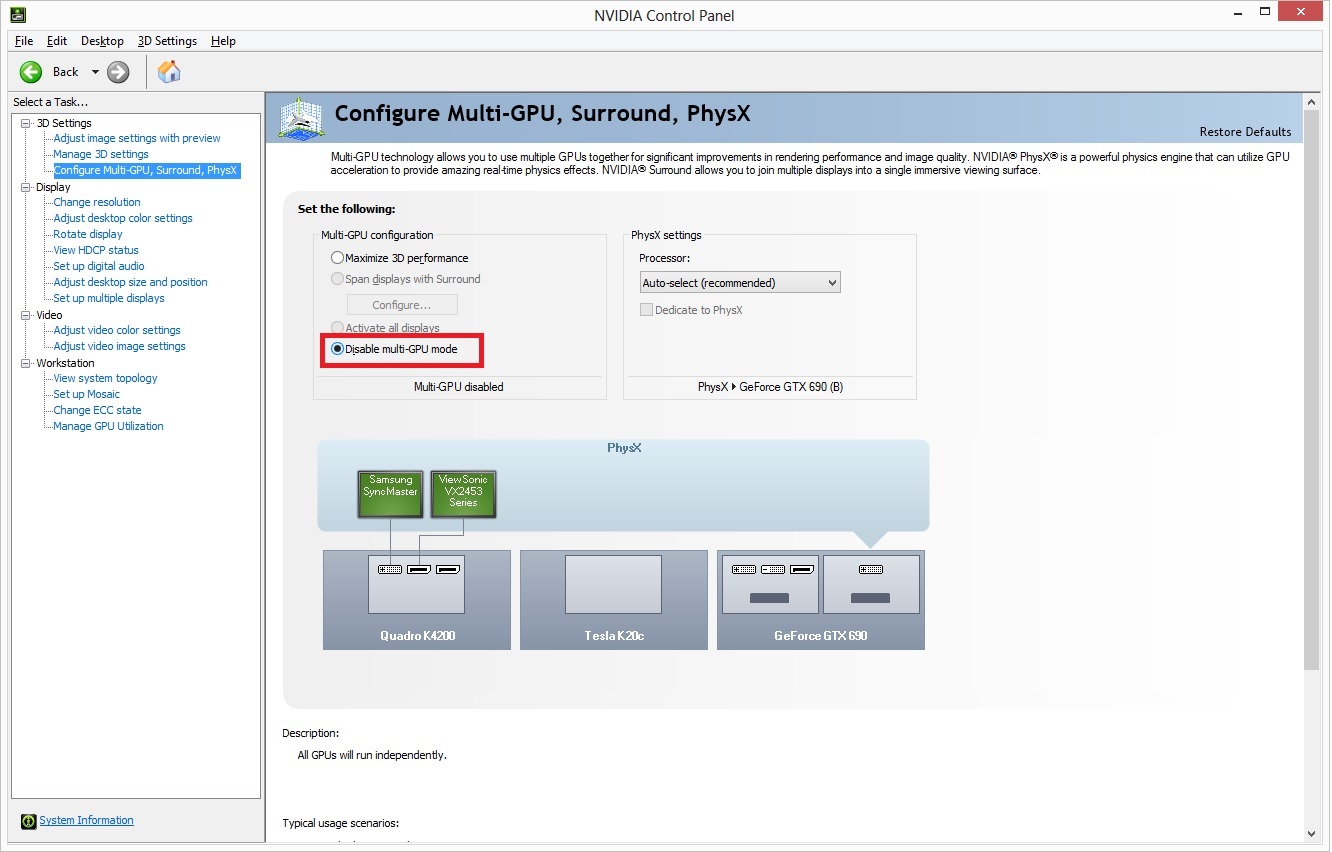

Disable SLI / Multi-GPU in the NVIDIA control panel. You often see extra memory usage like this when it's enabled.

Darn! You beat me too it! I just found out as well, it did the trick! (it is funny that the tick box says "disable multi gpu" though... )

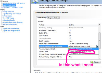

can anyone help me too
Do i need single mode? Right now it is chosen as multiple?
Thank you

coilbook wrote:can anyone help me too
Thank you
This setting will probably not matter. I would leave it at the default.
Thank you
Thank you

The setting you need to make sure is off, is this one:
