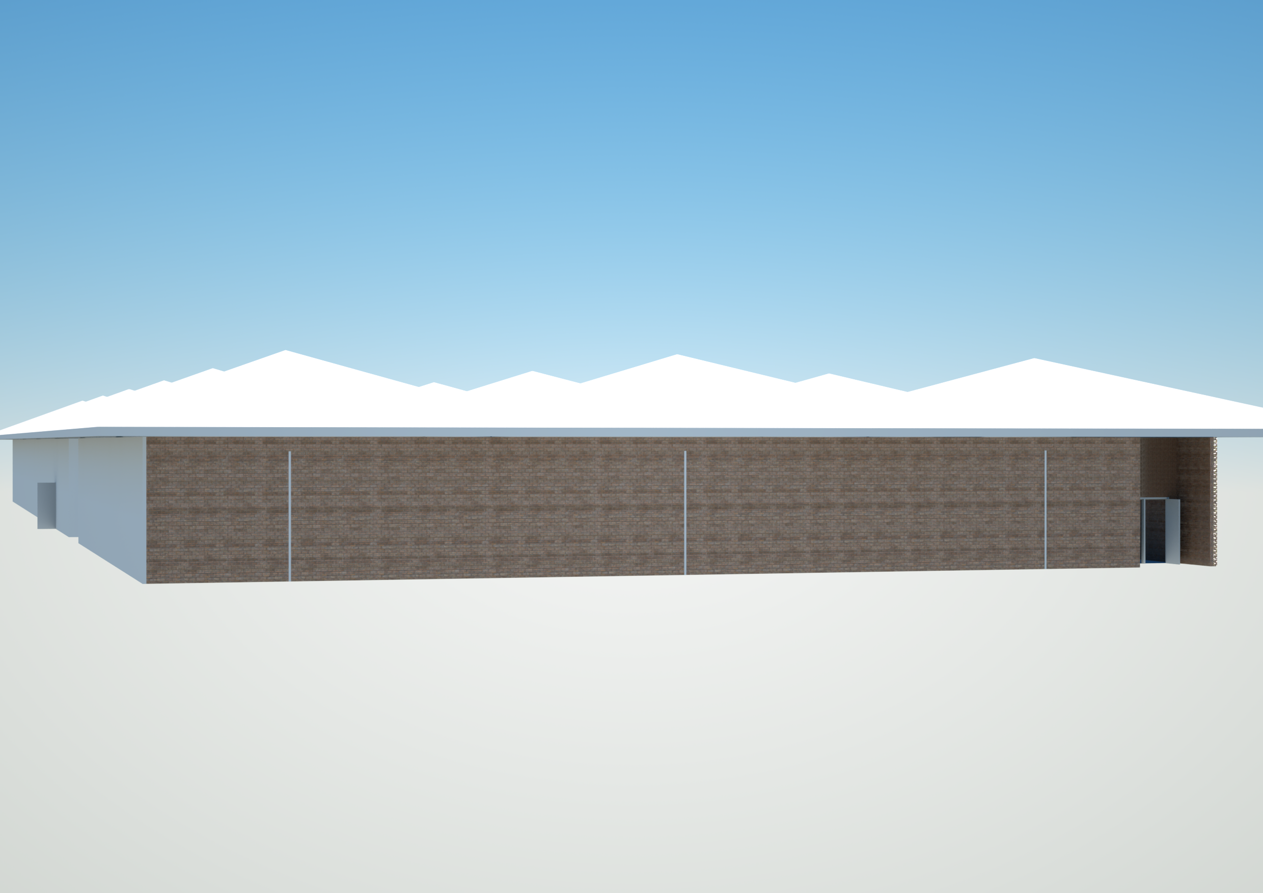

Hi Paul
Not sure if this attached or not. (now I see that it did)
I have a couple more to send will try again

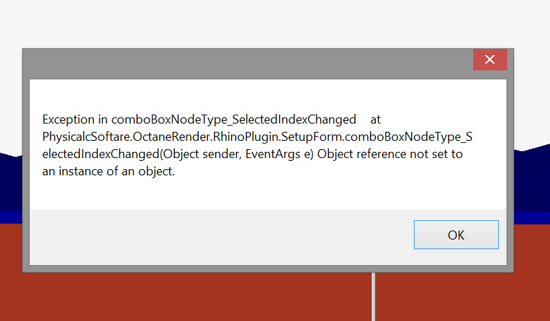

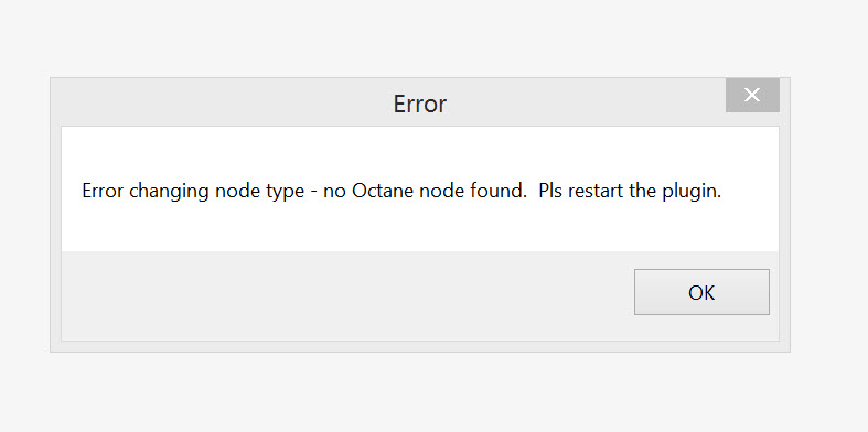

Hi Paul ..
I am attaching the error messages. This happens when I choose RGB Color for Power and Specular then change to another choice and try to change back.

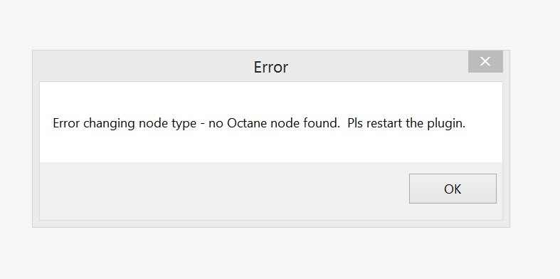

Hi Eric
With that error message - I cannot reproduce it. Can you pls give me the exact steps you are taking to get it? (ie. Start Rhino, new scene, open Material panel, create new material......etc).

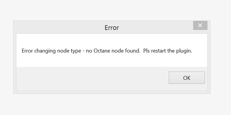

Trying again ... my last message did not go through ... I tried to send the .3dm file and I guess it was too much.
I noticed that the last time I sent the error messages that I duplicated and did not send the second one ... here they are again.
So ..
Open Rhino ... Select a material from the material window ... in this case 'brick' downloaded from the live db. Set it up so that 'diffusion/power', 'diffusion/specular' and 'bump/power' are all set to RGB color (with the color being an orange red brick color) .. looks good in the icon but renders brown.
Change 'diffusion/power' to greyscale color ... changes Icon to grey but renders brown. Change back and forth with all selections (usually this gets the error message but not this time) ... Change 'diffusion/power' to 'dirt texture' ... error message appears.

Maybe I have found the source of the problem. I am using a plug-in for Rhino called VisualARQ and it works with meshes that are not standard ones in Rhino but they are supposedly compatible. When I extended these walls up to meet the roof an offset appeared and the extension was set back from the face of the wall below ... it seemed unfixable so I created a surface and extruded it out to the original wall face (using standard Rhino tools. Then I ran a quick Octane render and the new solid extrusion rendered in the proper color as shown in the material icon. So there is an incompatible situation between VisualARQ objects and Octane. This does not bode well for VisualARQ in my book. It seems I won't be able to use it.

I was unable to get the errors you have been getting using the workflow you posted. It was unclear if you have the Viewport open or not (I assume NOT, since you did not mention it).
I was however able to get an error if opening the Viewport and then editing a material that was NOT used in the scene - and I will fix this.
