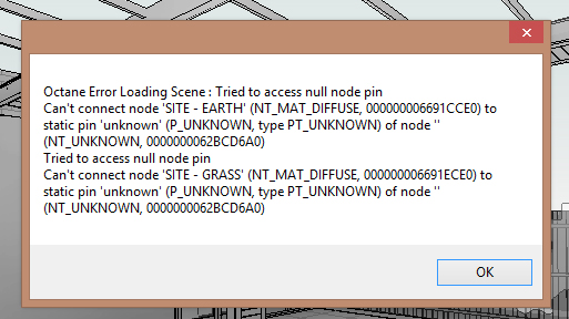

Hi Paul,
I've been battling this error message and I believe it was caused after renaming some materials within the revit library after having assigning an octane material to them, I have renamed them back to what they were originally but to no avail.
Thanks,
Chris.

face_off
Posts: 15813
Location: Adelaide, Australia
Chris - can you send me the rvt file pls? paul at physicalc-software dot com.
Paul
