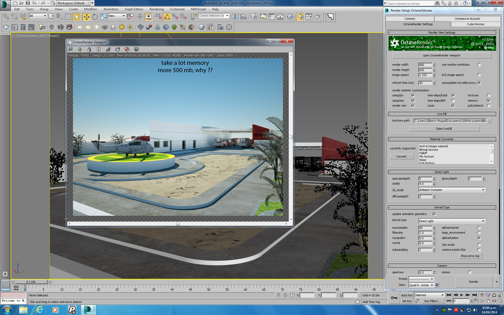

hi karba, the new versión take a lot memory, why ? more 500 mb, i am limited to use my gtx690

hi karba, the new versión 1.50a take a lot memory, why ? more 500 mb, i am limited to use my gtx690

merid888 wrote:hi karba, the new versión 1.50a take a lot memory, why ? more 500 mb, i am limited to use my gtx690
add image
1.50 takes into account render settings, like render iteration of mesh/turbo smooth and other kind of object. May be you set something too high.
add image
Could you send me your scene? I will investigate it deeper.

merid888 wrote:hi karba, i been sent a mail to this address [email protected]
thank you
Just checked.
Both versions take the same amount of memory +/- 20Mb
