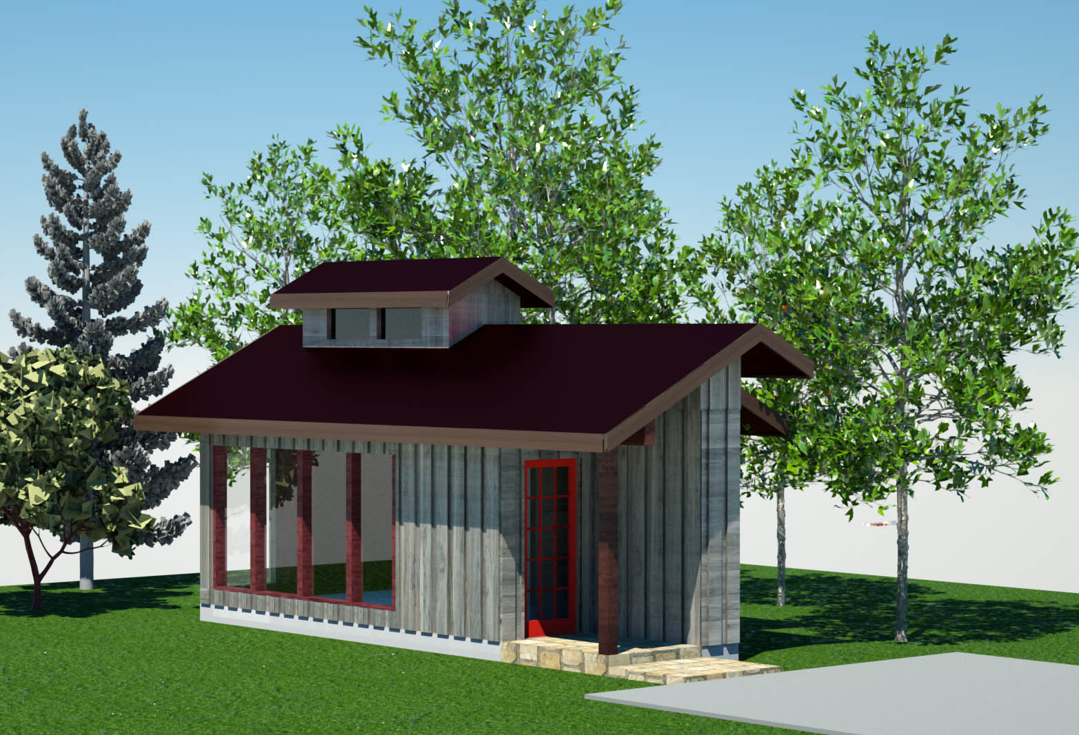

I'm attaching a quick render of a model I use for trying out trees and materials. I let it 'render' for 3 minutes.
