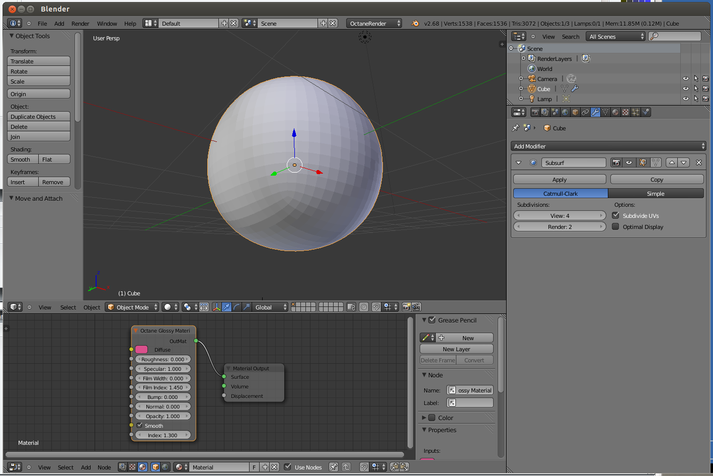

Empire-Arts wrote:4. Can octane render subdivided geometry that has not been applied in the modifiers window? This is for displacements and animating low-poly characters.
Yes.
