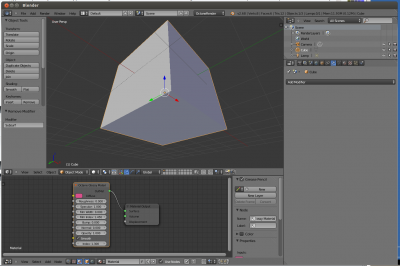

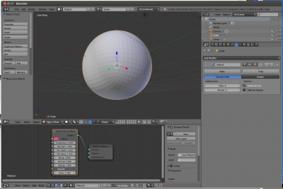

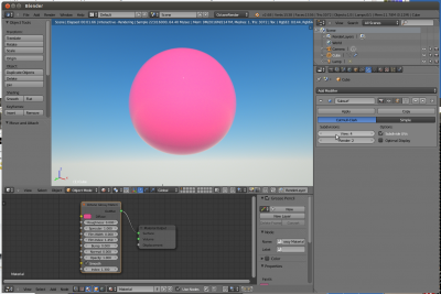

3. Are there any problems with saving a blender scene with materials and then rendering it in octane? I have run into this problem with the exporter. A saved file won't always export into octane for render if materials have been added in the wrong way.
4. Can octane render subdivided geometry that has not been applied in the modifiers window? This is for displacements and animating low-poly characters.

Yes.Empire-Arts wrote:4. Can octane render subdivided geometry that has not been applied in the modifiers window? This is for displacements and animating low-poly characters.
