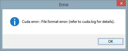

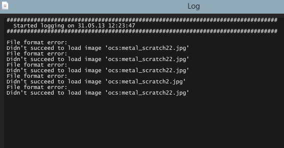

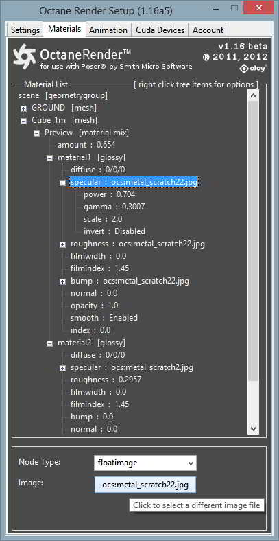

mlru
Posts: 239
Joined: Sat May 29, 2010 9:26 pm
face_off wrote:So far there appear to be 3 users who cannot get 1.16a4 running - and everyone else can. For the 3 users who cannot get it running - what virus scanner are you running pls? Also, have you tried re-booting?
I have repackaged everything and re-uploaded, just in case there is some odd firewall or file corruption issue. This version also fixes Uwe's problem.
1.16a5
- Fixed issue where clicking the "image" button was not bringing up the current image's default directory.
partially.
It works fine with textures I have stored locally in my runtimes, but I still have problems with images from the LiveDB. I did the following:
- loaded a simple cube
- in Octane-plugin i assigned a material from the LiveDB "metal panes - scratched"
- if I start rendering right afterwards, everything is OK.
- I save the file, close Poser and restart it.
- After reloading the scene and opening the Plugin, I get the cuda errors indicating the texture maps are missing.
It seems to me, images from the LiveDB are stored in memory and only as long as you don't close Poser. I scanned all my hard drives completely, but couldn't find the requested images. no luck with selecting from within the plugin either.
