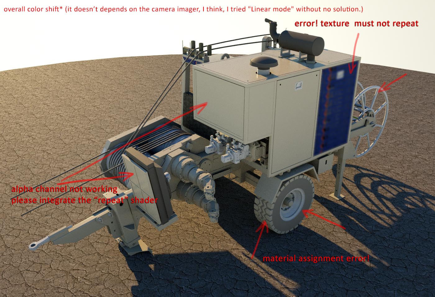

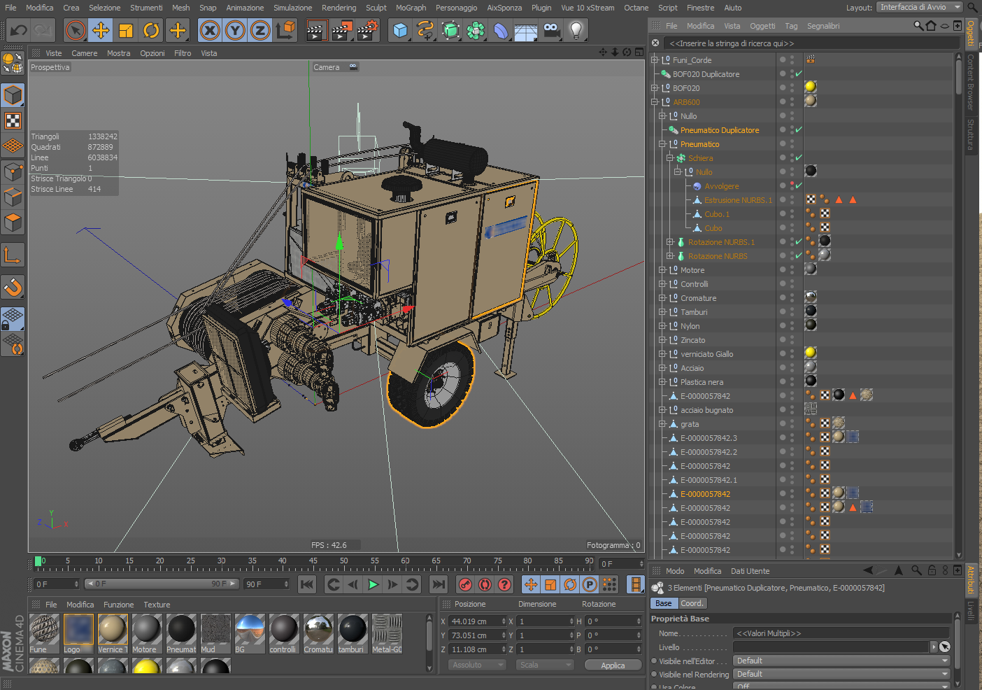

Hi, I found some errors... Can you help me?
The most important problem to solve is the assigning method, I think, because it seams that octane doesn't recognize some texture features, like: don't repeat texture (like a tile); receive material from parent.
My special wish for the next release is to integration of the "repeat tiles" map to be used into channels (in my scene there's an alpha channel).
I noticed an overall color shift ... the rendering result doesn't correspond to the assigned material. I know that it depends on many parameters like lighting and camera imager but... I used linear mode and I used color correction in PS without solving it.
Many thanks in advance.
Please, this material is only for your consideration and support.
Andrea Mannori
win 8.1 x64; nvidia 770M driver 340.52; octane standalone 2 + c4doctane 2.

Posts: 10544
renderfarmsrl wrote:Hi, I found some errors... Can you help me?
hi, you must convert your materials in order to get the best from the plugin ;)
for now is not possible to disable the tiling option for texture in octane, so you can't expect this feature in the plugin ;)
you must unwrap the uv or assign a mix material with the decal to a poligon selection of the object.
ciao beppe
