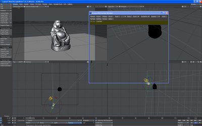

hello I have a problem with the IPR. is probably due to my old graphics card nvidia quadro fx 1700 512 mb. with stand alon, though slow, it works! can anyone help me? I attach a screen,
Pc laptop | Corei7 at 2.8GHz | 16GB | GeForce GTX 980M 8 GB | 240 GB SSD | 500 GB 7200 Rpm| Windows 8.1 pro 64 |
The released version of plugin may have problems with this old GPU. Please, write to me at [email protected] and I will send to you a pre-release of the next version who support the old nvidia GPUs.gigi wrote:hello I have a problem with the IPR. is probably due to my old graphics card nvidia quadro fx 1700 512 mb. with stand alon, though slow, it works! can anyone help me? I attach a screen,

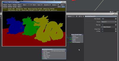

Any way ever to have material ID buffer. I am using shift camera in the plugin so I not think there is a way to match camera in Lightwave native for workaround for ID. Also maybe in future some type of wizard for surface creation would be great if Live does not work with plugin for Lightwave. Similar to Maxwell in Lightwave.
You can use the InfoChannel kernel node to render a meterial ID buffer.vpii wrote:Any way ever to have material ID buffer. I am using shift camera in the plugin so I not think there is a way to match camera in Lightwave native for workaround for ID. Also maybe in future some type of wizard for surface creation would be great if Live does not work with plugin for Lightwave. Similar to Maxwell in Lightwave.
-Juanjo
