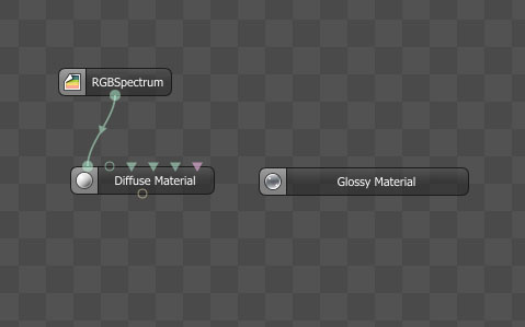

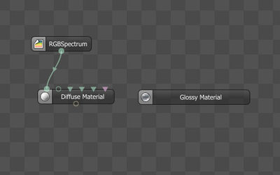

Has anyone else noticed this?
version: beta 2.2 RC2
When you create a material , for instance a diffuse, and then switch it to something else all the little dots in the node graph disappear.
However if you have connected another function to the base shader first, it doesn't happen.
Here is a screen capture.
I think it's a new bug, tested with the beta 2.1 and everything works fine there.
