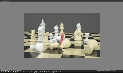

Here's the chess scene with 2 6800XT Duos.
Posts: 10564
Big thanks danchosich :D
Do you mind to redo the test with only one W6800 Duo active?
I'm expecting 8/9 sec :roll:
ciao Beppe

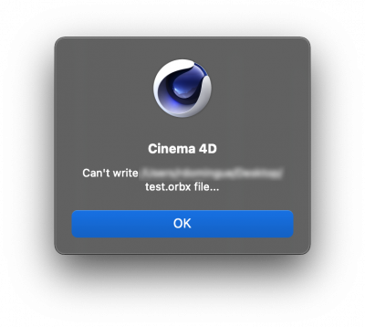

I'm having issues exporting an Animated .orbx from Cinema 4D/Octane X Big Sur PR 11. I'm getting a Can't Write error in C4D dialog window once the files is prepared for export. Is there a permission I need to set somewhere?
Can't write error.
Can't write error.
Posts: 10564
@nibbler: you should have to compare OctaneX render time with OctaneRender 2020.1.5 CUDA, and I have two machines, one Mac Pro with 2x Vega II (~400ob), and one PC with 2x 2070 Super (~400ob) that are rendering the same .orbx scenes almost with the same rendering time.
Also PR3 cannot be taken as a reference, since OctaneX was not complete at that time, have you tried with PR6?
@rondomingue: weird, never seen that message :roll:
Have you tried to save it in a different path?
Does it happen only with this scene, or with any scene?
