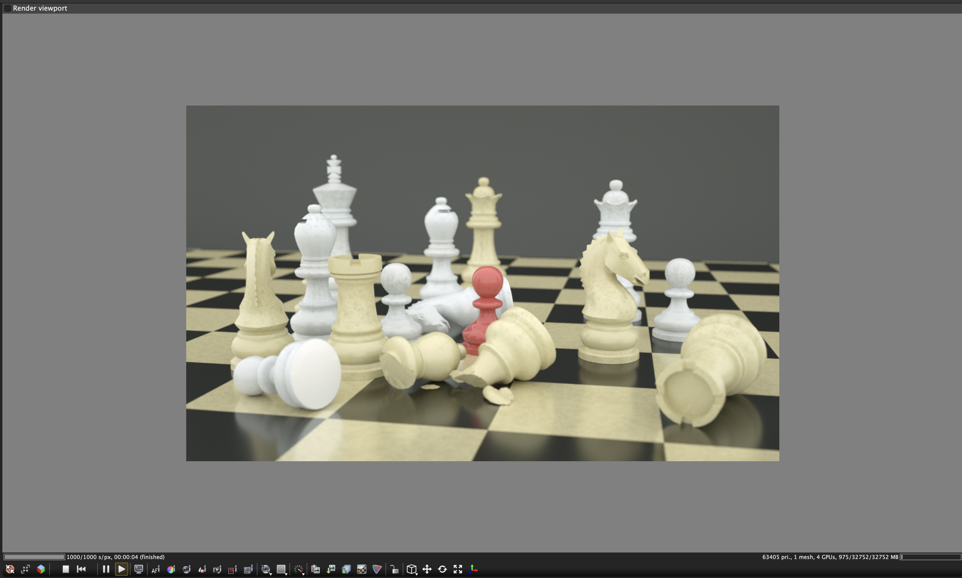

Here's the chess scene with 2 6800XT Duos.
Posts: 10517
Big thanks danchosich :D
Do you mind to redo the test with only one W6800 Duo active?
I'm expecting 8/9 sec :roll:
ciao Beppe

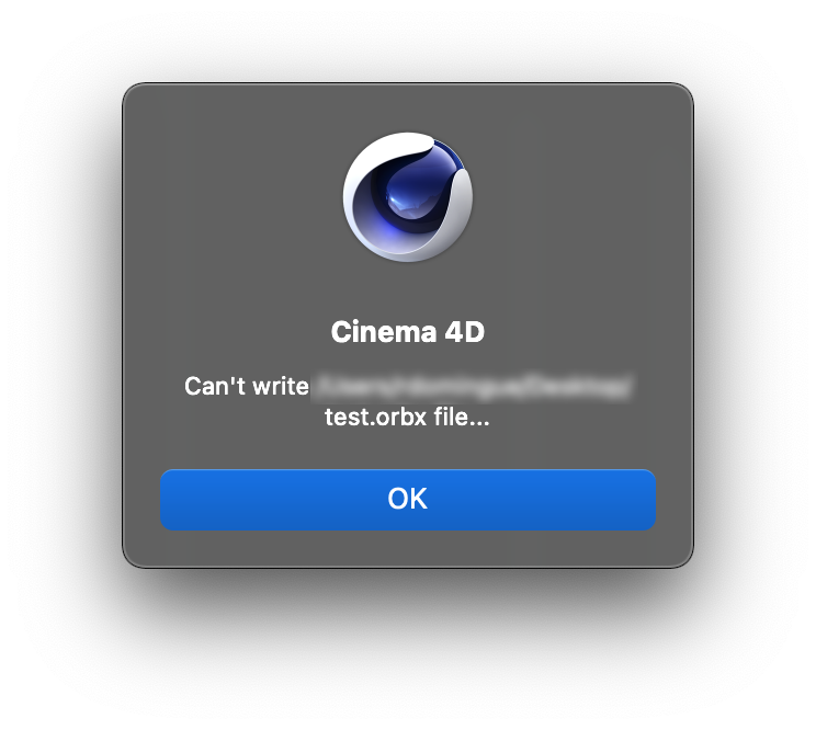

I'm having issues exporting an Animated .orbx from Cinema 4D/Octane X Big Sur PR 11. I'm getting a Can't Write error in C4D dialog window once the files is prepared for export. Is there a permission I need to set somewhere?
Can't write error.
Can't write error.

@rondomingue: weird, never seen that message :roll:
Have you tried to save it in a different path?
Does it happen only with this scene, or with any scene?
ciao Beppe
