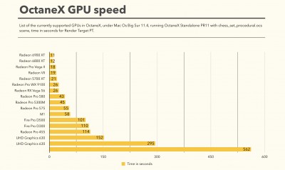

I have MacBook Pro 16, with AMD Radeon Pro 5500M, which eGPU I have to buy, to work with Octane X much faster? Both of then will be working?
Posts: 10635
Hi pobedeen,
yes, if you add one or two GPUs via Thunderbolt 3, you can render with 2x/3x GPUs at the same time.
OctaneX scales linearly, and the boost depends on the AMD GPUs you choose:
Please note that also VRAM amount is important.
The GPU with less VRAM defines the limit of the system, since the whole scene must be loaded in each GPU.
So, if your internal GPU has 8GB of VRAM, and you add a GPU with 16GB, the internal GPU must be disabled, to be able to render with more than 8GB of VRAM.
While, if the scene stays in 8GB of VRAM, you can render with both GPUs at the same time.
Happy Mac GPU rendering,
ciao Beppe

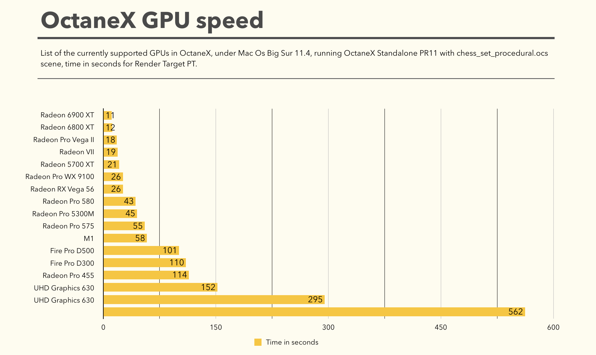

With two W5700x, with the chess set procedural, I am getting about 10 seconds on render target PT. That seem about right correct?
I have two 6900xt I will test with tomorrow as well.
rondocap
Posts: 2
Joined: Thu Jun 17, 2021 3:42 am
Tested on a 2019 Mac Pro, 28 core - two 6900XT. Octane X score is 6 seconds on the chess scene. Dual w5700x was 10 seconds
Posts: 10635
Thanks rondocap for sharing your results!
Yes, Octane scales pretty well in Multi GPU mode.
ciao Beppe
