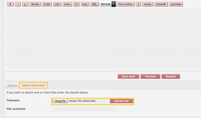

Ps. how do you attach a screenshot here?

Hi Remyrond,
to add a screenshot, or example scene, please choose "Upload attachment", while editing the message:

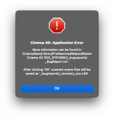

Is Otoy still planning to develop OctaneX? The last update was in April and the current version cannot be used normally. This beautiful window pops up on average every 5 minutes. In every newly started project.

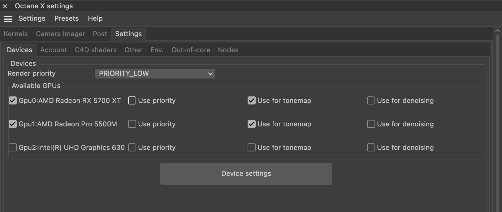

Posts: 10635
please completely disable the Intel GPU in Octane Settings/Devices panel, also for Tonemap, if present, and render only with AMD GPU for now.
You need to go to c4doctane Settings Devices panel, and disable all the checkboxes:
ciao Beppe

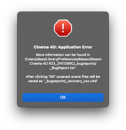

I'm not using an Intel GPU, I know it causes a lot of bugs. Unfortunately, turning it off does not save me from error.
These are caused by small shader changes like a rescaling in UV Transfrom, sometimes even a simple color change in RGB Spectrum. The program switches itself off an average of 10-15 times per hour.
MacOS 11.4 is installed. I have to admit, it's hard to do anything on Octane X :(
