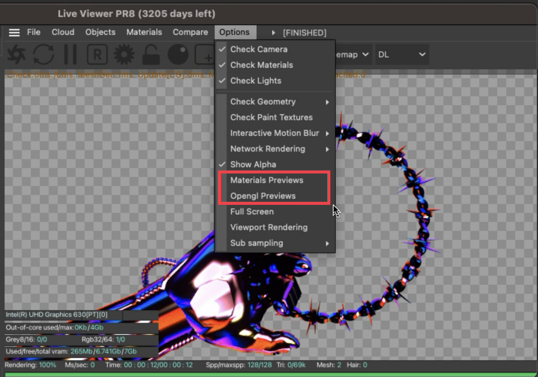

Hi guys im new with Octane. Im on Mac Big Sur 11.2.3 Intel Iris 655 and Octane Prime PR11 whenever I try to render something with octane material or object in c4d (s21) it goes Compute error 2097152:2891: and Octane materials don't show just black squares. Standalone works well. but what to do with c4d?

@ alexnesh: Intel GPUs have issues with OpenGL and Materials preview, Standalone doesn’t have this part.
Before loading a scene in Live View, please go to Live View menu Options, and disable both OpenGl and materials preview:

thanks a lot!
