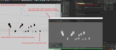

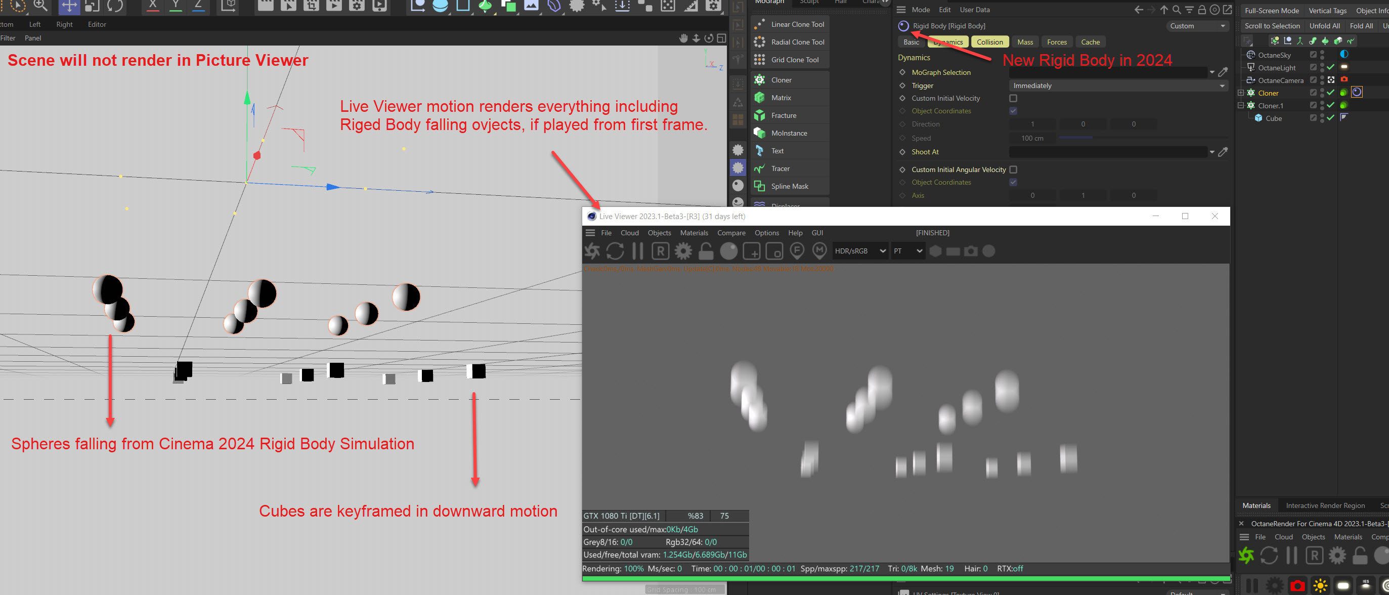

Hi I have a test scene that uses Cinema 2024 new Rigid Body simulation system and I can't get motion blur to render in the Picture Viewer. Please see attached.

I also should mention that on my Windows 10 system, trying to render this file in the picture viewer leads to one of three results.
1) The file is rendered but without the dynamic spheres.
2) The file renders all black.
3) The file completely freezes and must be forced quit in the task manager to get out of the freeze.

MichaelJeffreyVance wrote:I also should mention that on my Windows 10 system, trying to render this file in the picture viewer leads to one of three results.
It seems that the new dynamics system doesn't work with Octane motion blur. If you turn it off in Object tag it works fine.

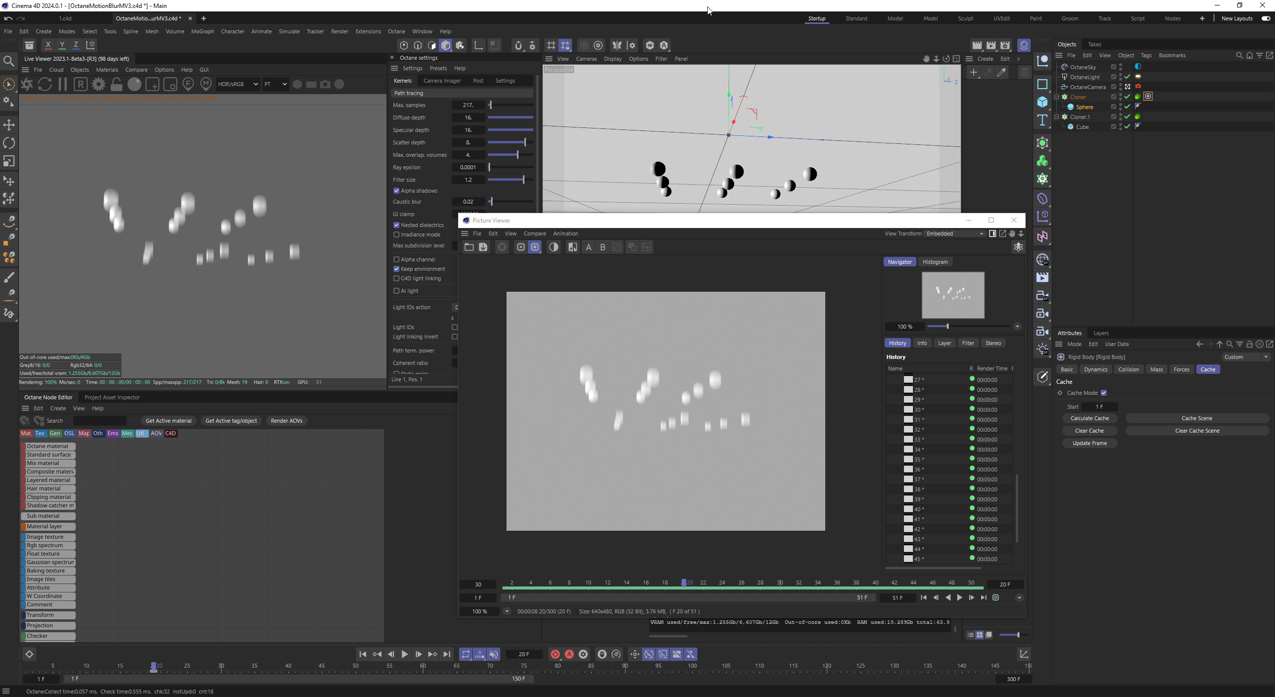

MichaelJeffreyVance wrote:Hi I have a test scene that uses Cinema 2024 new Rigid Body simulation system and I can't get motion blur to render in the Picture Viewer. Please see attached.
The attachment 2023-09-22_01-44-02.jpg is no longer available
The attachment OctaneMotionBlurMV3.zip is no longer available
It's not working because you need to cache the dynamics. We are using a temporal copy of scene for data and it requires to have data. Caching provides that. See the picture!

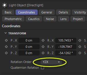

You need to have "Rotation order = YZX", it will be fixed to have it by default. Also change the power from light tag, not from light object.

SSmolak
Posts: 1157
Joined: Sat Feb 07, 2015 5:41 pm
Location: Poland
aoktar wrote: And here, everything is working well in Camera tag. Be sure you are using the latest fixed build or try this new test build.
https://render.otoy.com/customerdownloa ... T1_win.rar
Thank you Aoktar ! This test1 version works fine with Camera Tag - previous still had issue with xpresso. DirectLight fine too as you described.

MichaelJeffreyVance
Posts: 33
Joined: Tue Mar 05, 2019 8:02 pm
Ah I see. It has to be cached. Thanks. That seems a tinsy bit inconvenient, but having the ability is the important thing.
