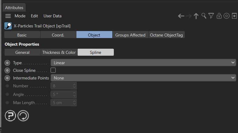

Using Render As Hair option in the Object tag on an XpTrail object crashes C4D instantly. Running the latest updates on R23 and XP.
Edit: narrowed down what's crashing it. Changing any of the parameters from the default under the Spline section on the XpTrail option will cause an immediate crash.
