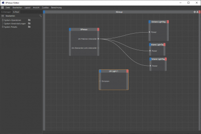

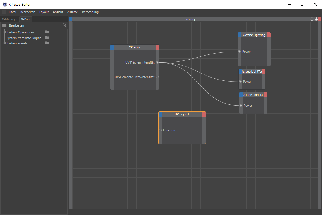

I try to connect an emission power node in Expresso but can't find it in the list of available nodes.
How can I control power of a texture emission via Expresso?
Is this possible is this missing?
Thanks for your help!
Ron

Ron, best way to do it is to right click on the attribute you want in xpresso and choose Set Driver. This will create an xpresso tag, which you can then copy and paste into your xpresso (or, just build from there -- either way works.)
