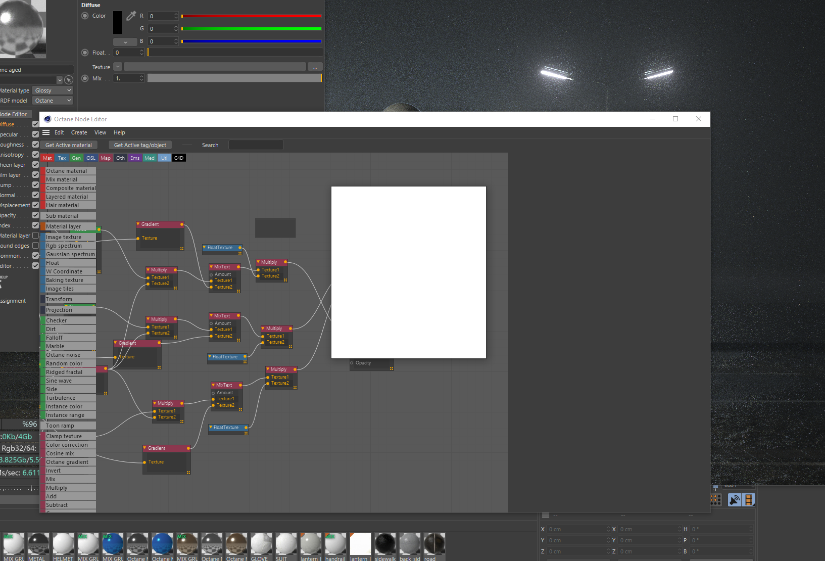

raulofs wrote:Hi Ahmet, I have had a problem with the plugin for a long time and I didn't want to send anything until I was sure it wasn't a problem with my pc, but I did tests with 2 totally different computers and the problem keeps happening to such a degree that it makes me very difficult to work. I'm going to send him a compiled video and log files to see if you can determine what is happening. This is happening to me with almost all the scenes when I start to make them more complex. I hope this helps you and the problem can be solved. I had to postpone several jobs due to this error.
Note: This only happens if I use the octane render plugin, it does not happen with another engine.
I also tried an older version 2020.1.5-R4 and it is unstable
Thanks, Ahmet.

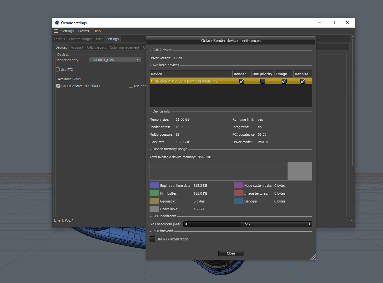

Interesting problem, haven't see it before! Could you close all other software and remove other plugins? Disable RTX and denoiser. Let me know if still happens.

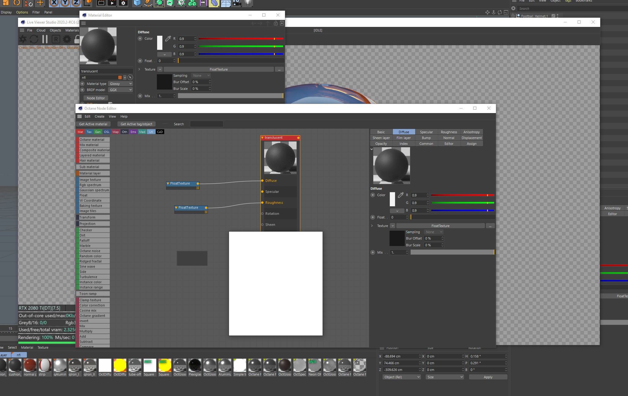

Thanks for your reply. Ok, I deleted the cinema preferences and left only the octane render plugin. Also close all the windows programs that were running in the background including adobe and stuff and the result is the same.
I send the files with the new tests
Thanks Ahmet.

I did tests removing RTX and the denoiser, it's the same
Thanks Ahmet.

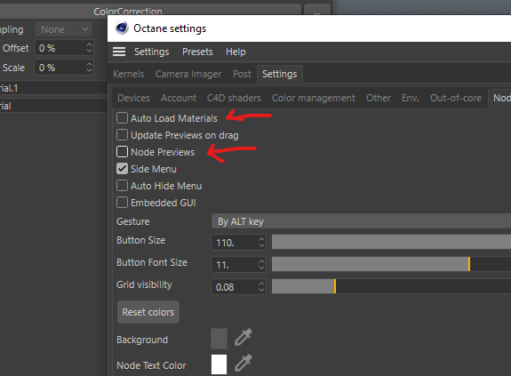

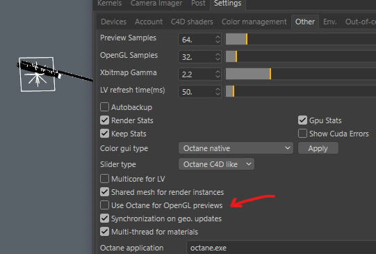

Can you disable the all preview options for opengl/materials and nodes and try again? Also did you try with a clean install of C4D?

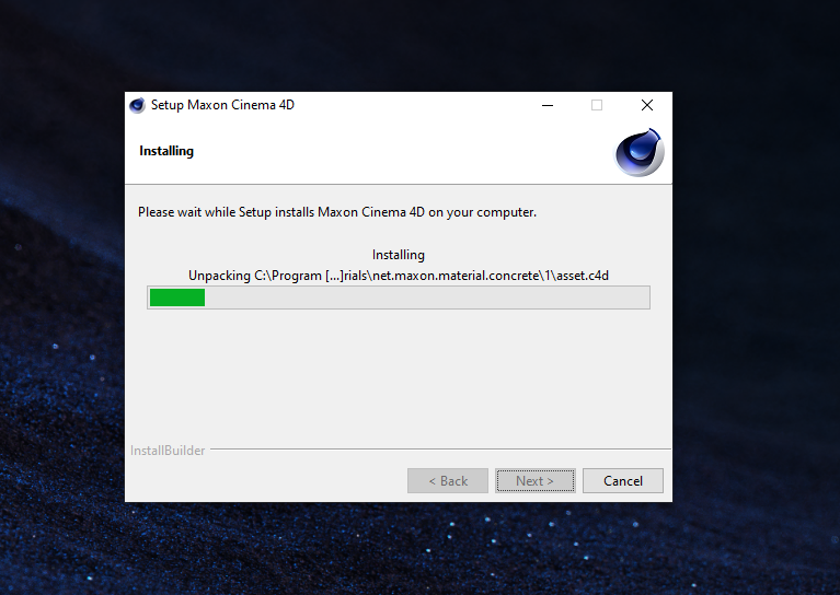

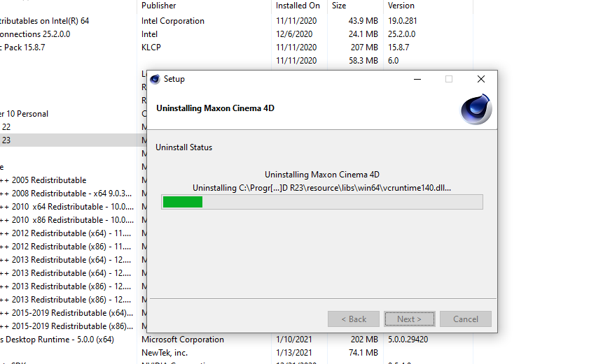

Hello, completely uninstall cinema 4D and delete all the program folder, I reinstalled only Cinema and the plugin and deactivated all the preview options but it keeps happening, It has been difficult for me to advance in my work :(
Thanks Ahmet.

It looks like a strange problem. Sent you a PM
