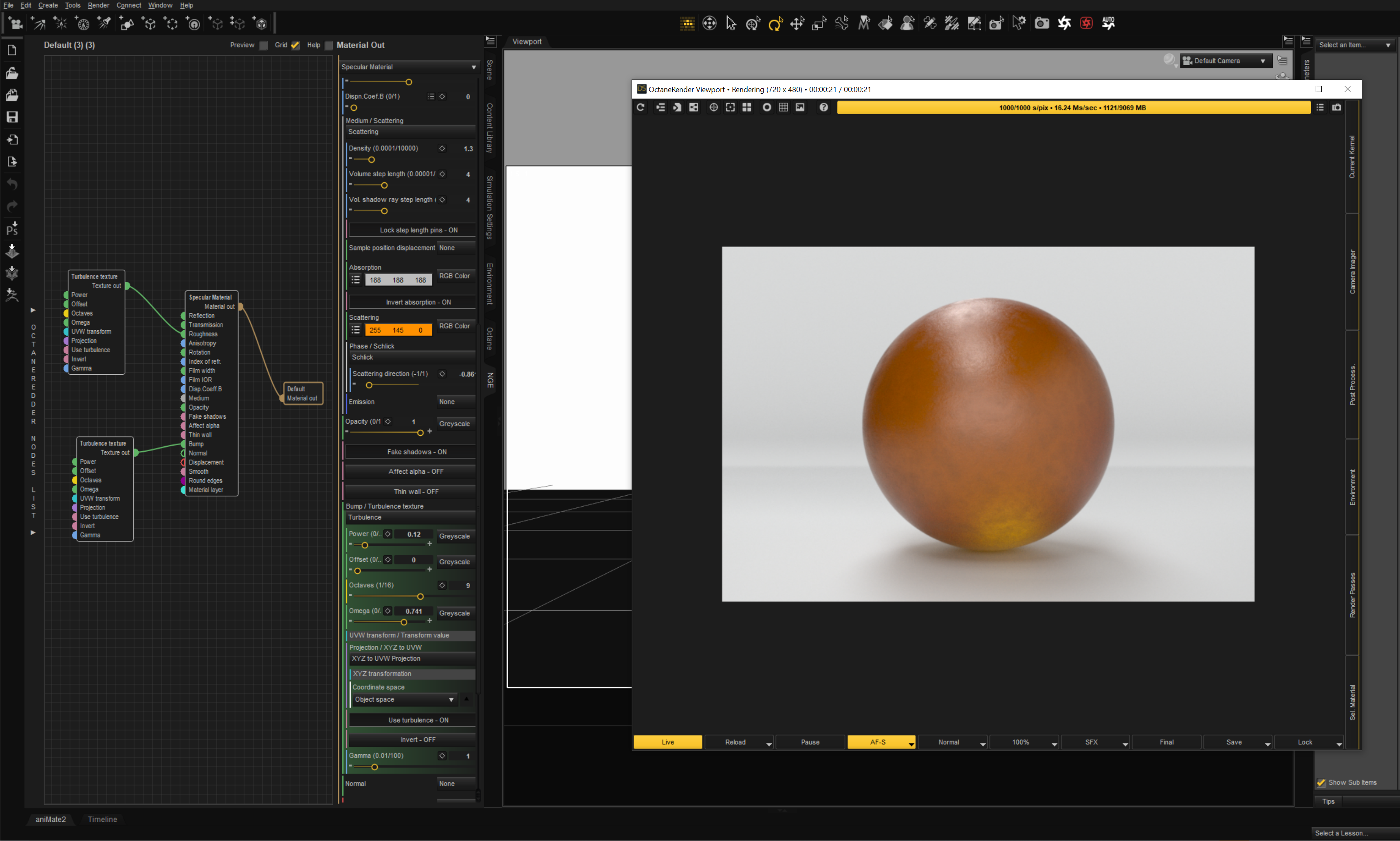

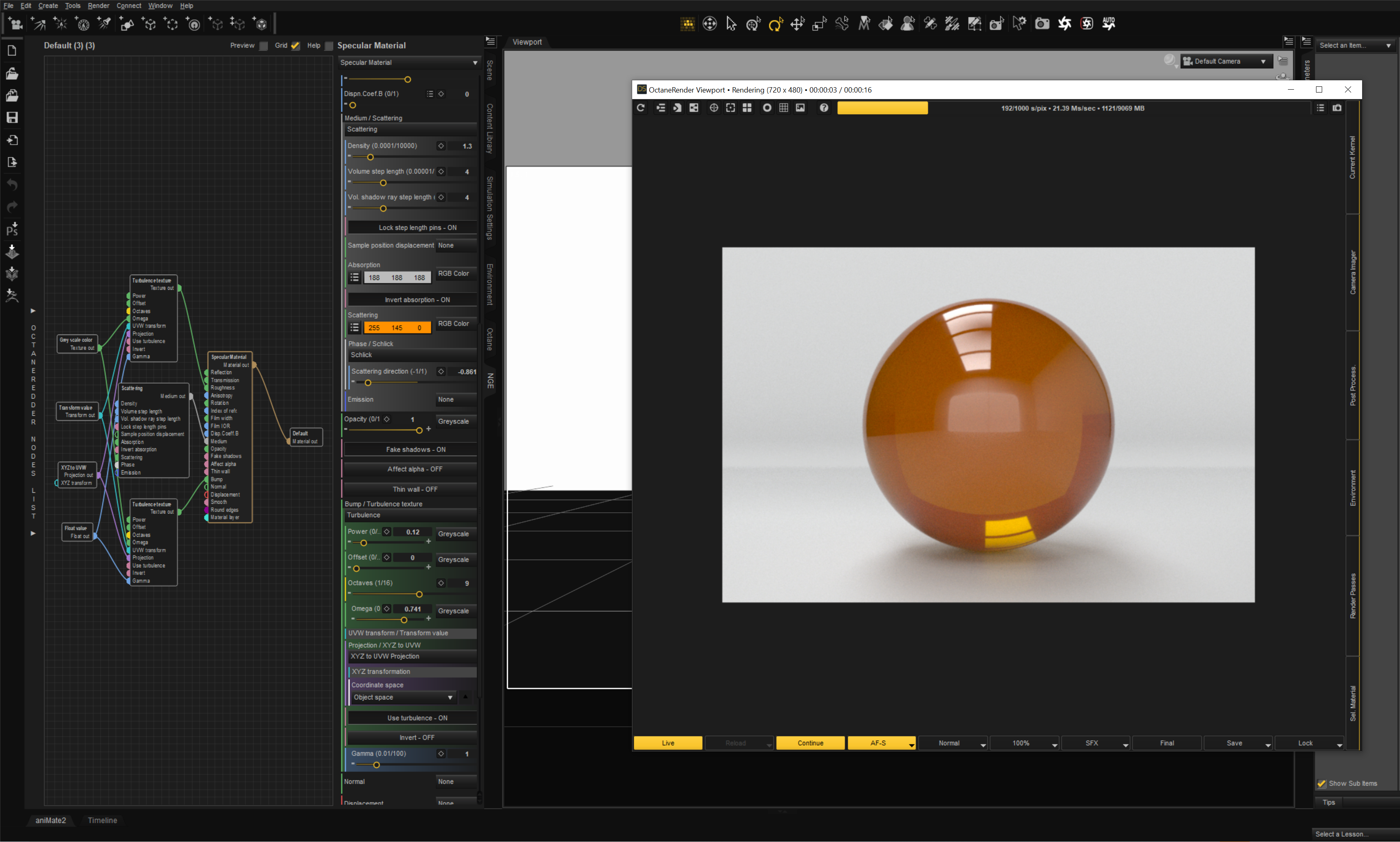

Hi Paul,
I have been able to reproduce this issue from my end. New Scene, new material, simple setup. Before and after pics plus scene attached. All details remain the same but Smart unfold seems to be affecting the rendering result.
I'm right-clicking on the Specular Material node and then pressing Smart Unfold.
I did not add nodes from the node list when creating this material but added from inside the material structure.
The scene:
Octane_Smart_Unfold_Test.zip
(79.73 KiB) Downloaded 256 times

Hi - I replied to your original reporting of this issue as follows:
Thanks for providing the scene. Perhaps you could help here...to me it looks like unfolding a non-material node works OK, however when a material node is unfolded the result is a corrupted material, and the Amber Scene Surface can no longer be selected. I also notice that changing pins on the Mix texture doesn't restart the render, so there has been a break in the link between the Octane node in the NGE and the Octane node in the render engine.
Looking at the code, there is no obvious issue, and I suspect the issues around Smart Unfold have been there since the feature was added. My best guess is that fixing this would be a major undertaking.
I think the best solution is to disable the Smart Unfold option on Octane Material nodes.
Thoughts?
Paul
