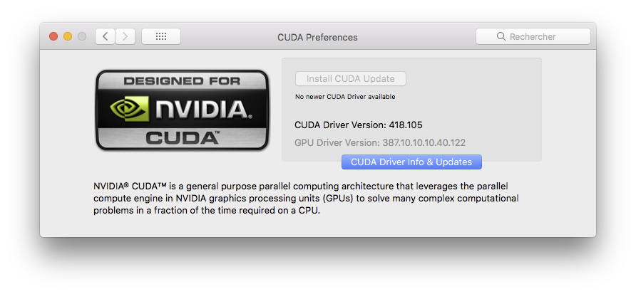

Hello,
I use Octane 4.02.1 on Cinema 4D R18 on Mac OS X 10.13.6 and I have a problem because the Live Viewer window does not show anything.
I'm using a GeForce 1080 GTX 1080 8192 MB card
I installed the latest version of the driver Cuda Nvidia V. 418.105 and I wonder if the problem comes from that.
If so, what is the best way to install the previous version please?
Here is the content of the Octane log :
Started logging on 30.03.19 21:44:21
OctaneRender Studio 4.02.1 (4020100)
CUDA error 715 on device 0: an illegal instruction was encountered
-> kernel execution failed(kernel0)
-> failed to deallocate device memory
-> could not get memory info
Thank you,

Posts: 10544
jbecaud wrote:Hello,
Thank you,
With Mac, you need to go back to 410.130:
https://www.nvidia.com/object/macosx-cu ... river.html
and install directly on top of the current installed version.
ciao Beppe
