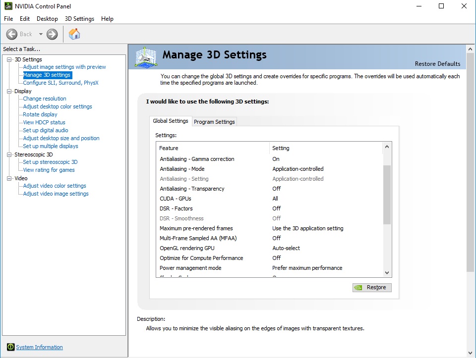

@Notiusweb-where do u set this max performance settings?
Thx
G
Notiusweb
Posts: 1285
Studio21 wrote:@Notiusweb-where do u set this max performance settings?
Thx
G
In Nvidia Control Panel:
"Select a Task" window bar on Left
3D Settings (dropdown)
"Manage 3D Settings"
In Global Settings Tab Window, under "Settings:"
Feature - "Power management mode"
Setting - Prefer Maximum Performance
(Click Apply)
When I use this, temps will run higher on cards because cards won't return to idle as much, and when they hit their top, they will stay there longer because they are not pulled back down immediately from max power usage.
But trade off is that PC is not throttling power to cards up and down, so there are less system flags and alerts involving power usage by the GPU that may trigger a protective shutdown by the PC.
Apparently from reading online, PC throttling power to cards may otherwise be a reason if PC reboots during rendering processes, or gaming.
