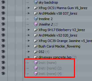

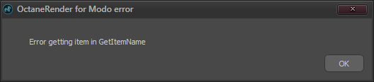

been getting this error today, no idea why.
Modo will then crash immediately after.
EDIT:
I found the problem, turns out there were a few 'ghost' instances, never seen this type of thing before. But after deleting them the error went away.
Dino - can you send me a scene with a ghost instance pls, and I will fix the crash.
Paul
No problem you can find the scene here:
http://www.mediafire.com/download/14p4t ... _scene.zip
Cheers,
Dino.
