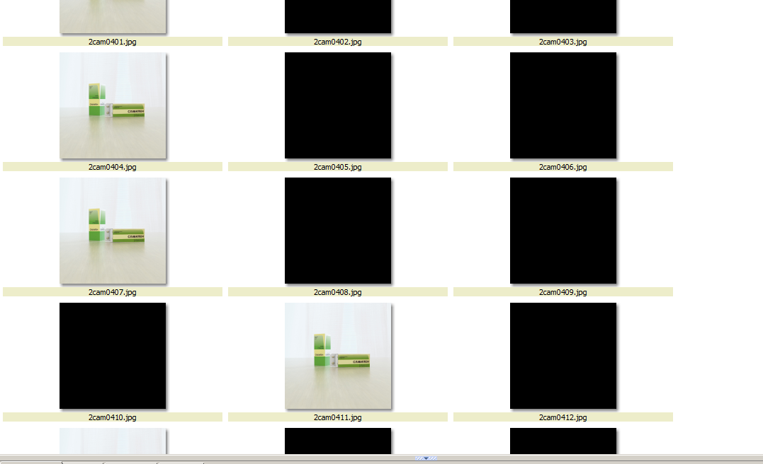

dropped to 15 version - problem with alpha channel + occurrence in sequences of black frames when rendering animations
darkline
Posts: 291
Joined: Wed Mar 07, 2012 11:56 pm
same here. I did a 300 frame animation and there were 10 black frames in the middle - very odd.

Are these frames rendered OK when you render just one frame that is rendered black in animation rendering?
darkline
Posts: 291
correct Jim, just random black frames which otherwise would render normally.

2016-02-29 11-05-42 XnView - [Обозреватель - D  ##___VIDEO___## slabilen final RENDER 2cam ].png
It is interesting that the sequence of black frames is saved... if I remove the sequence of images and re-render will have black frames will be in the same order

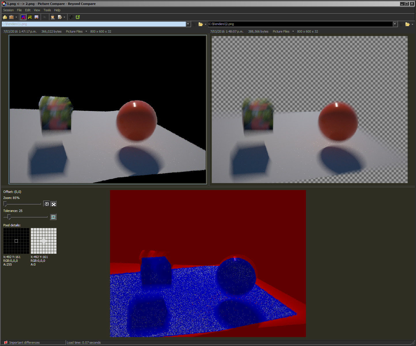

when tone mapping does not work alpha !!!!!!
response - LINEAR - save *PNG
JimStar
Posts: 3837
Goldisart wrote:when tone mapping does not work alpha !!!!!!
This is a bug in 3ds Max' Bitmap. As soon as the image buffer having non-1.0 gamma is loaded into Bitmap - Max screws up alpha during saving a PNG from Bitmap window.
I've found some workaround for this, will be OK in next version. So far as I suggested before - use 1.0 gamma in Octane imager.
A left image is saved when a buffer of Max Bitmap is filled by 2.2-gamma image, and the gamma of a Bitmap is set to 2.2. A right image - all the same but the Bitmap buffer is filled by 1.0-gamma image and the gamma of a Bitmap is set to 1.0.
In the first case - Max screws up the correct alpha value "0" and turns it into "255".
