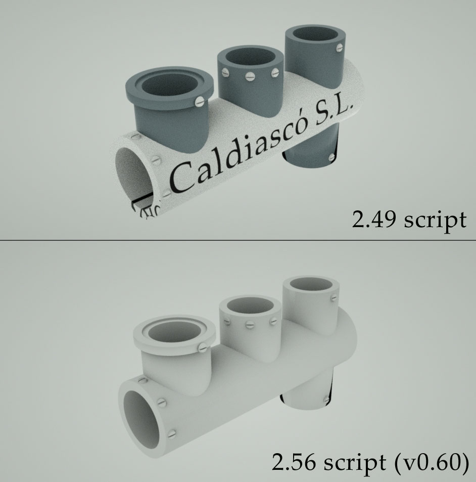

I have several problems with the UV's, in Blender looks OK , I mapped the UV's as usual but in Octane Render the results is completly different, do you know why?
- SamCameron
- Posts: 162
- Joined: Sun Jan 02, 2011 12:58 pm
A quick update about problems:
I've been researching in the forum about UV's problems with Octane/Blender and looks like Octane cannot handle Clip textures, only Repeat, that's more or less fine (I wish to use Clip but nothing is perfect), the problem is with the script wich provides wrong information in materials and coordinates, I tried the 2.49 script and automaticly exports all the objects with materials and textures, also the right coordinates, please check this comparisson:
