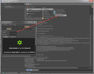

i can't find the related post. I saw a question about TR and license. There is a picture to show how can we activate plugin from TR client.
