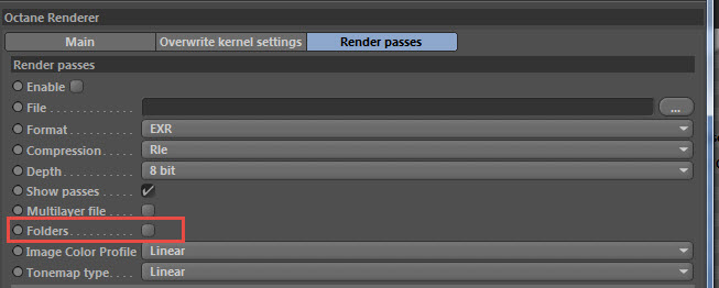

Ok, I'll ask again.
Where is gone the option of placing render passes into folders?
It was a very great feature, which allows faster load time passes to After Effects.
The second issue is the rendering queue in Cinema R16 (Windows 7). The program renders only one scene, and at the next scene the program freezes. R15 version does not have this problem.
Thanks for any help.

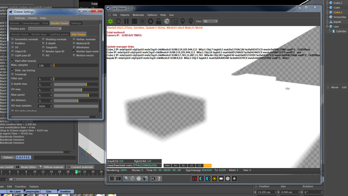

I have one question for infopasses (User Pixelkingdom asked something like this before).
Is there any chance for getting blurred layermasks? Am I missing something, or is this feature just not supported yet. Just curious.
In one of InlifeThrills tutorials the same issue appears, though actually it didn't seem to be a problem for him :).
best regards
Posts: 16068
Location: Türkiye
Effekt-Etage wrote:Hi aoktar,
thanks for those fast updates. Really appreciating the improved Render-Layer system. Keep it up.
best regards
Hmm, what's the problem? Are we talk about dof+render layer masks as in picture?

Dean wrote:Ok, I'll ask again.
Yes, here. It's hidden feature. Will be appeared when you uncheck "multilayer file". Also there is a bug in sdk about passes's render progress. This causes random pauses
Dean
Posts: 22
Joined: Sun Oct 05, 2014 3:42 pm
Okay, so it works only in files that have the possibility of layers (tiff, psd, exr)
In the files (jpg, tga, png) which can not turn on the multilayer there is no folder options, unfortunately.
---update---
There is a bug in this setting. When set to EXR such as folders option is enabled, we also have in JPG, PNG, and TGA. However, when the multilayer EXR is enabled, then for the JPG etc. there is no option folders.

Effekt-Etage
Posts: 12
Joined: Mon May 31, 2010 2:59 pm
best regards
ah ok, thx
I took the sample-File concerning layermasks from the opening-post as a reference, so I gues that was the problem.
There the "Render Layer Masks" box under infopasses wasn't checked, just the layer mask ID boxes, which already gave me my black/white passes.
So after checking "Render Layer Mask" box, masks have dof included, which is great, but still no motionblur. Any further tips?
Posts: 16068
Location: Türkiye
Effekt-Etage,
Really, that's correct. I'll ask for that to Strafied(Thomas). He may have a explanation for that.
