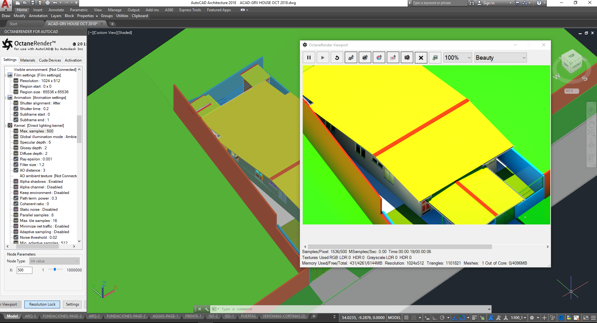

Hi Paul,
sorry for being late too.
1 - For Autocad 2018 the plugin´s version is 3.7.0.22 (64 bit) that you uploaded , it is a different version from 2019 (3.08.1.23), but works fine.
2 - Yes works fine (Octane Standalone 3.08.3)

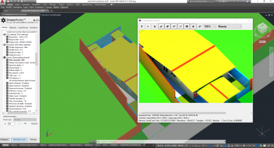

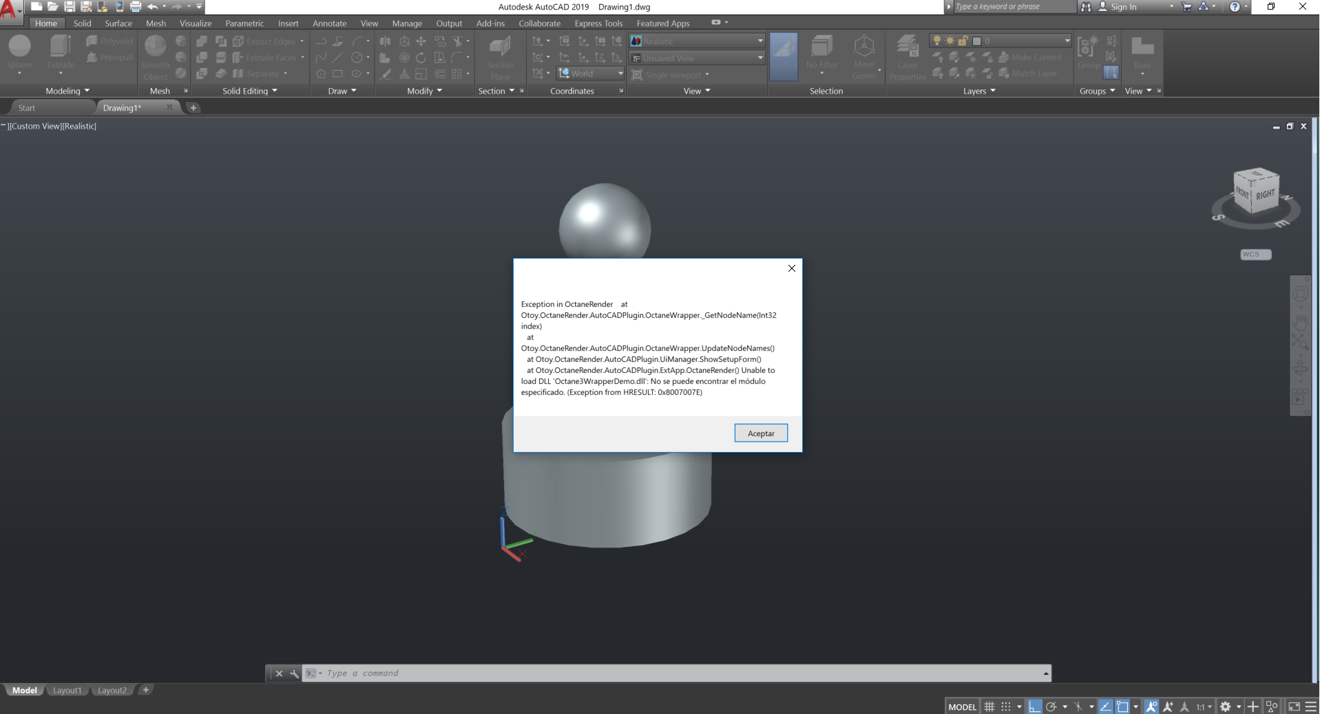

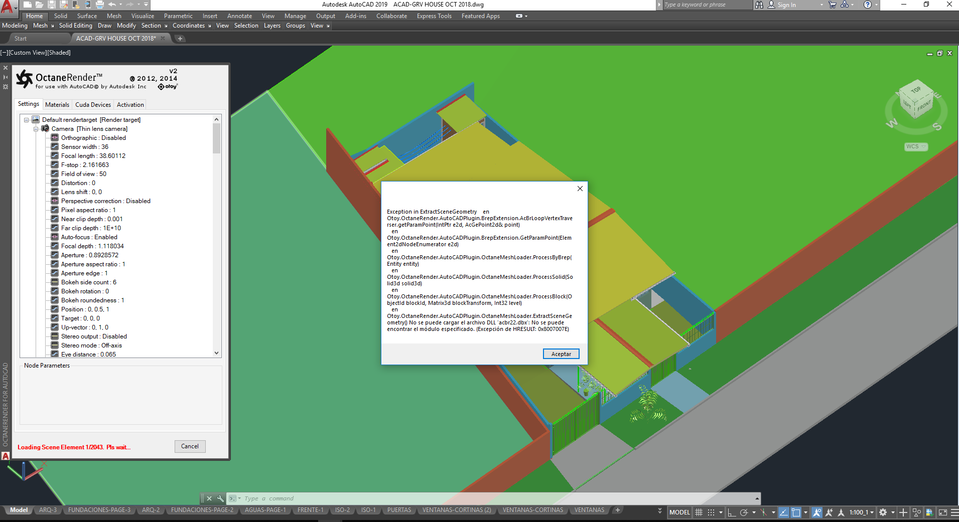

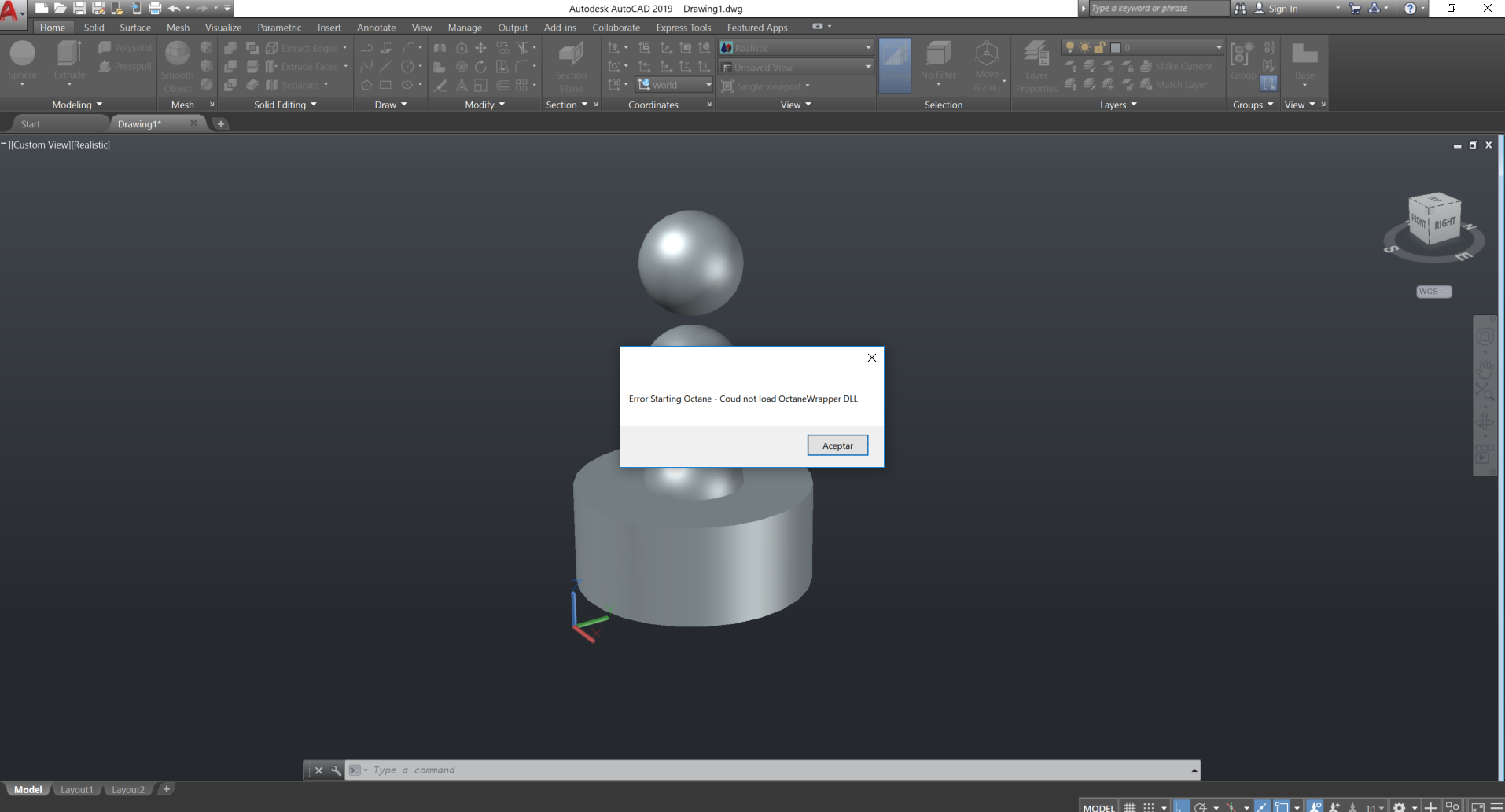

Hi Paul, sorry for this late reply.
Now the 2019 plugin works fine (at least it loads); ACAD 2019 loads the plugin but it only render simple geometry, when you try to render more complex geometry it fails to load. In ACAD 2018 plugin load perfectly. I had attached some sample pics.
Laptop- Win 10 64- 32 Gig GTX 880m 8 Gig - Desktop Win 10 64- 16 Gig GTX 980 ti 8 Gig
This looks like a bug in AutoCAD. acbr22.dbx mention in the error does not exist with AutoCAD 2019 - only for AutoCAD 2018. Can you pls send me a scene which produces this error?Now the 2019 plugin works fine (at least it loads); ACAD 2019 loads the plugin but it only render simple geometry, when you try to render more complex geometry it fails to load. In ACAD 2018 plugin load perfectly. I had attached some sample pics.

Hi Paul, I just uploaded the Autocad tested file.
Guillermo R.

I have updated the STABLE build at the top of this thread with:
3.08.5.25 (18-Oct-2018)
- Compiled with Octane 3.08.5
- Fixed AutoCAD 2019 exception
Paul
