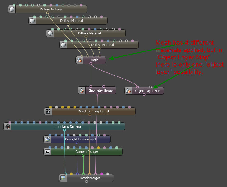

Does an "Object Layer Map" functionality is implemented in Rhino? If yes, how to use the functionality? I would like to utilize "Object Layer" node so I can toggle "Camera Visibility" and "Shadow visibility" functions, as available in Octane Standalone.
Also, I also tried to export the scene from Rhino and opened it in Octane Standalone, but the "Object Layer Map" functionality seems to be not working as displayed in the attached image.

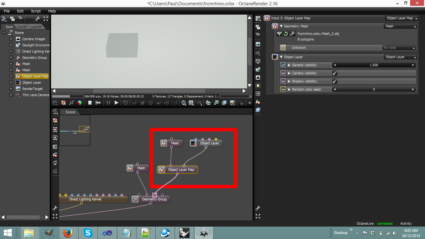

Hi. If you be great to implement Object Layer in Rhino, however, I think the Octane Object Layer Map node really needs to be linked to the Rhino Layer, and there is not an obvious way to link the Object Layer Octane pin values to the Rhino Layer (visibility is fine, since it would come from the Rhino Layer visibility, but Camera Visibility and Shadow Visibility are a problem). Alternatively the Object Layer Map could be attached to each individual Rhino mesh, and controlled from the Geometry tab of the plugin, although I am concerned this might be confusing to users. I would appreciate any suggestions users have on this...
Use the lay-out I have posted below.
