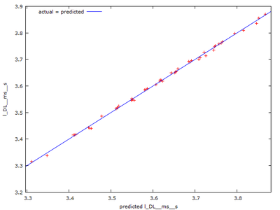

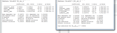

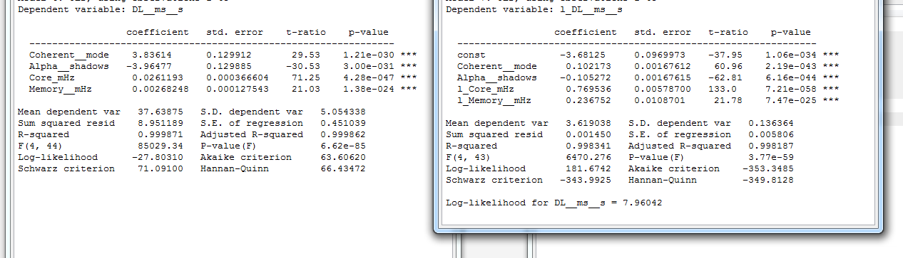

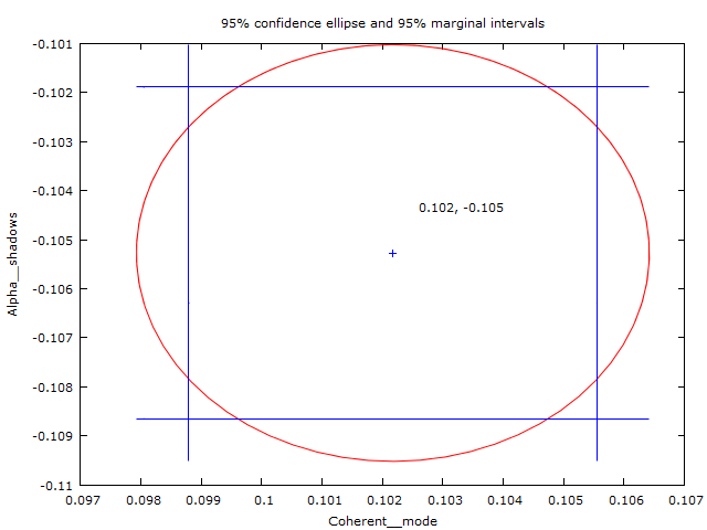

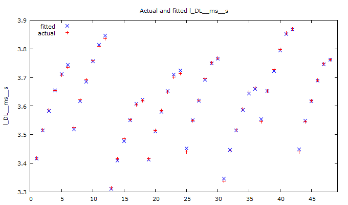

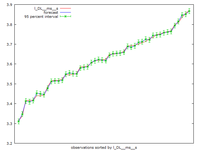

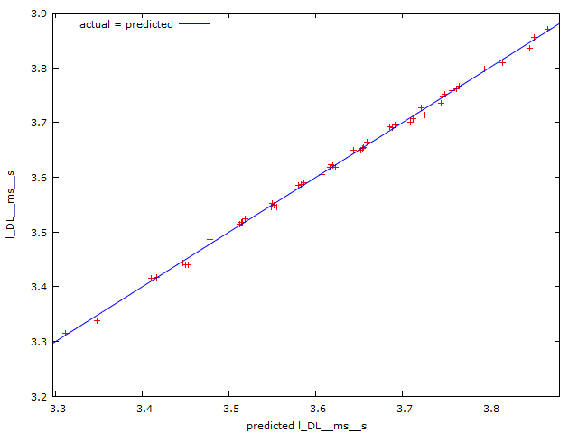

Econometric analysis of efficiency of Octane Rendered watercooled workstation.
Let's go with some more scientific approach of how good is the water-cooled workstation. Please forgive me if I do too many shortcuts here. I'll answer all questions with pleasure.
One GTX 780 is used.
I've measured Octane speed for 5 variables:
- DL speed (PT and PMC to bo done) in ms/s - as a dependent variable; also in logarithmic form for elasticity interpretation
Independent variables
- Core clock in mHz, from downclocking to 862mHz to overclocking up to 1320mHz (1293 stable), also in log form
- Memory clock in mHz - two measurements: 3005 and 3506mHz, also in log form
These logarithms give me ability to measure of how much I gain in speed performance in overclocking core or memory clocks (ceteris paribus, all other variables constant)
- Binary variable - alpha shadows on 1, off 0
- Binary variable - coherent mode on 1, off 0
So here you are guys.
Interpretation
For levels constant was not significant - removed, all variables (independently) are significant (p-value almost equals zero), join variability very high with high Fischer stat (significant),
Now some important info for Octane Users:
- every 10% in CORE overclock lead to increase of DL speed by 7.7%
- the rest if the effect (2.3%) is due to memory overclock
SO it is much better (3x) to focus on core overclock.
Coherent mode turned on increases (on average) the DL speed by 10%
Alpha shadows reduces it by 10%
