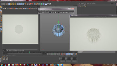

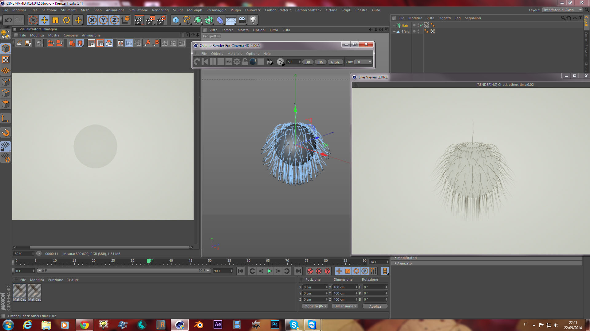

Hello Beppe !!
I have a problem with my hair ... not only in reality but also in rendering now !!
When I use the Octane renderer images you do not see one single hair, even if I try everything. (While in live viewer only guidelines appear well .... I think if I do "generated spilane" I can perfectly render the hair ... but always in the live viewer). I hope you can give me a hand ... I thought that someone else had this problem and expect you to solve it for me! But ... it seems I'm the first

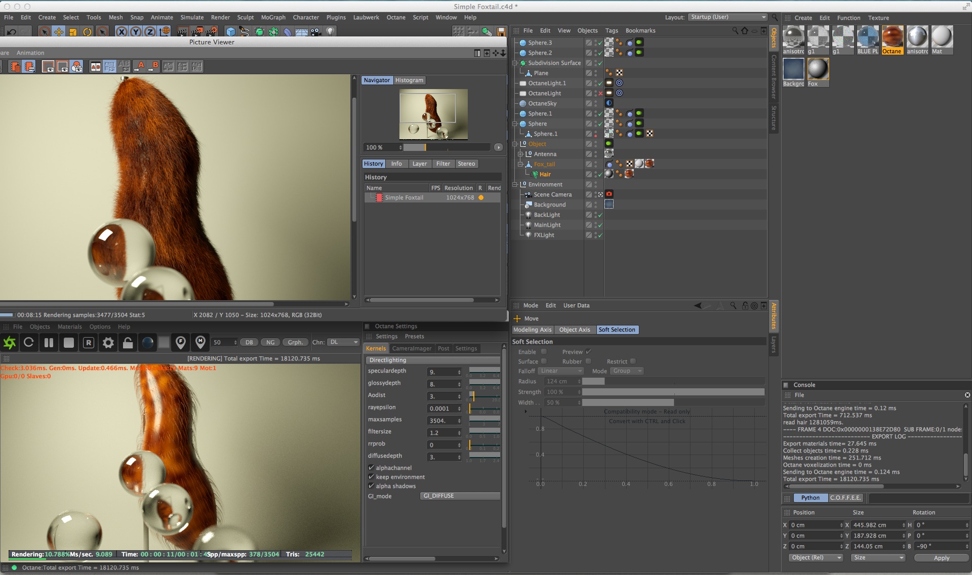

hi,
here is a screenshot from an example scene provided by aoktar in the first post of this discussion: as you can see, the guides numbers correspond at what you see in the live view, while the hairs numbers are relative to the picture viewer
p.s. in reality, i have very few hairs to play with

bepeg4d wrote:hi,
Grazie Beppe !!
