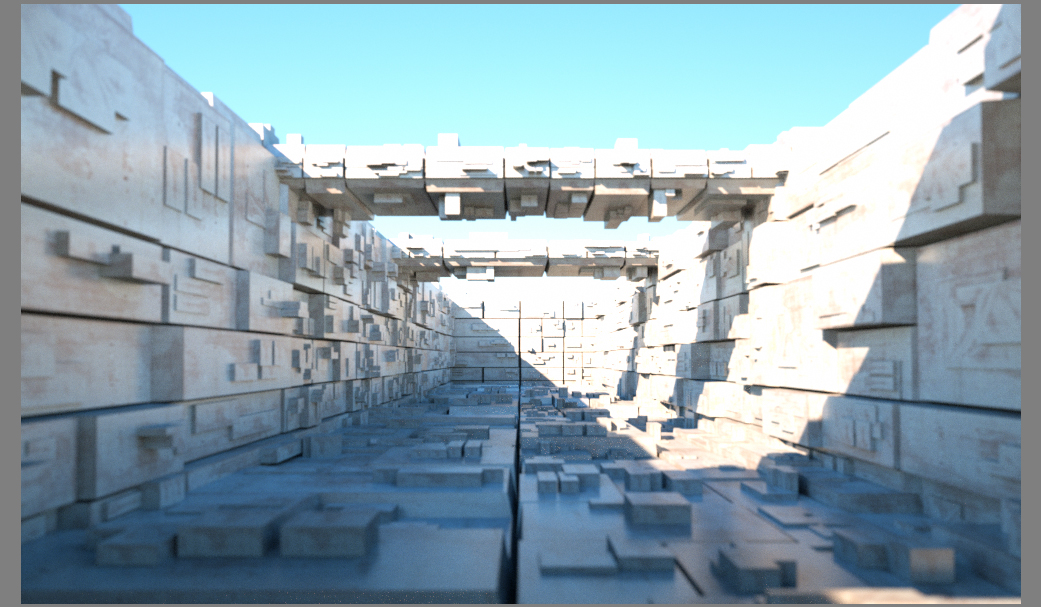

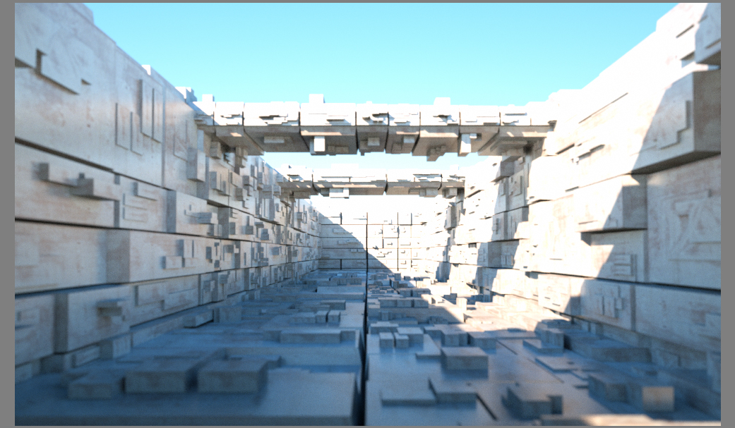

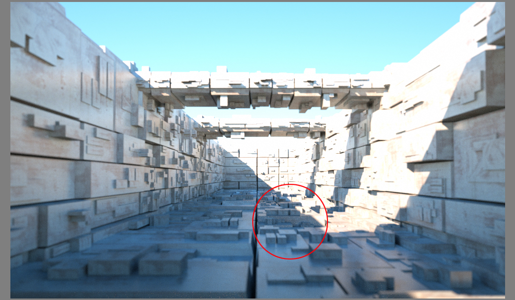

2.01 marginally faster than 2.00, but 1.54 faster still and resolves better.
octane render 2.01 40.62ms noticeably more fireflies
octane render 2.00 38.58ms still unresolved fireflies
octane render 1.54 45.27ms and much cleaner

MrFurious wrote:2.01 marginally faster than 2.00, but 1.54 faster still and resolves better.
I thought you were talking of a speed drop from 2.00 to 2.01.
Yes, Octane got slower from 1.5 to 2.0. We added a whole lot of new render features which all affected render speed, even if the features are not used. It has been discussed a lot on the forums the last weeks. We are still working through a list of ideas, but there is only so much we can do here, so I can't make any promises that we can improve performance further in the near term.
The trench scene is affected more than most scenes, which is because it's dominated by ray-tracing (it has only one trivial material). Here on my 690 I see even a drop of 18% in path tracing, but in most scenes "only" 5-10%, in some cases 2.01 has the same speed as 1.5.
I'm worried about the noise though: Doesn't look right and we will have a look at it.
EDIT: Some parts are also rendered differently. Only direct lighting seems to be affected.
Thanks for pointing out the noise. There is a bug in direct lighting that creates that huge amount of noise. It will be fixed with the next release.

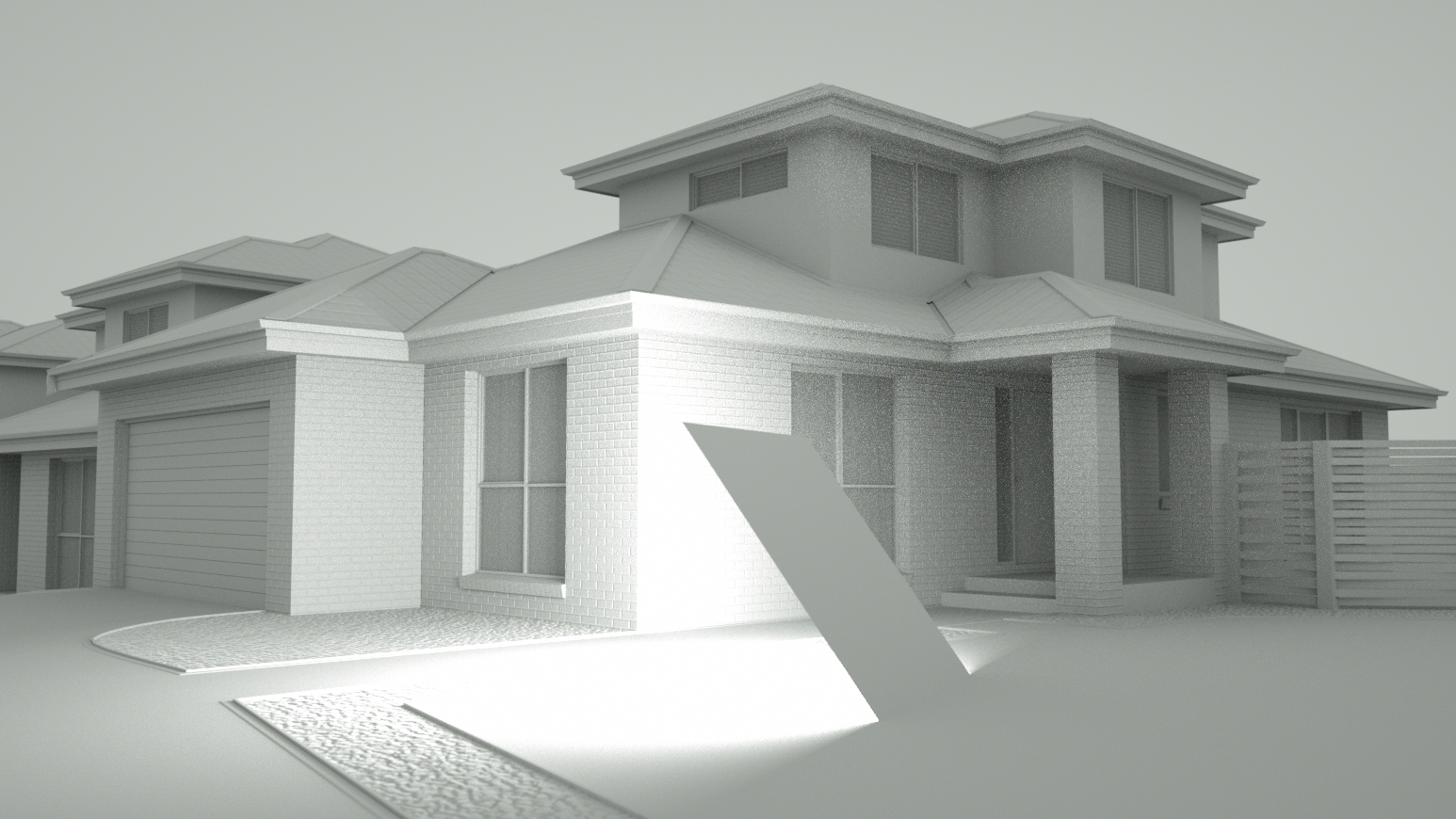

Location: Melbourne, Australia
Only noticing this now playing around with the LW plugin.. indeed tons of noise with 'Diffuse': very simple scene, a single arch model and a single light using DL diffuse. Background noise taking ages to resolve. May need to switch back to 1.54 until this is addressed.
