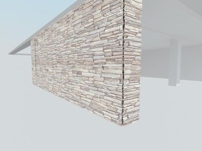

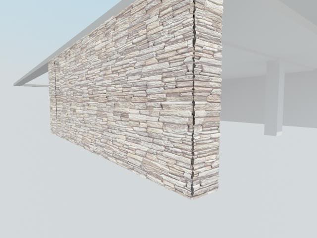

I have a question how does displacement will work on a cube object, does it will have keep continuity or it will have come out edges??? this is just an example----
Karba
Posts: 2300
relox wrote:it will have come out edges??? this is just an example----
It will. There is no way to avoid it. you can play with displacement shift to keep seams as close as possible to each other

What will happen if rounded edges are applied to a displacement surface joint like this?
Seeker
mbetke
Posts: 1307
Location: Germany
Can't you just chamfer this edge and unwrap it properly to avoid this kind of edge?
Games use it this way since a long time. If you just add a cubic unwrap the seam will appear. with proper UV-Mapping it shouldn't.

Thanks karba, if you have some example with the width a wall facing to the camera it will help alot, if its not i will wait a bit to someone makes an expample, yes i can chamfered the walls but i have it tested with other software Corona with a wall chamfered occurs the same cut edges it will display but not like if the wall was a square object,they look less.
