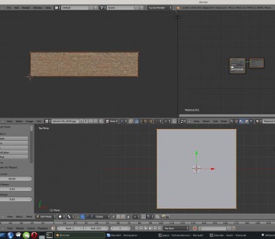

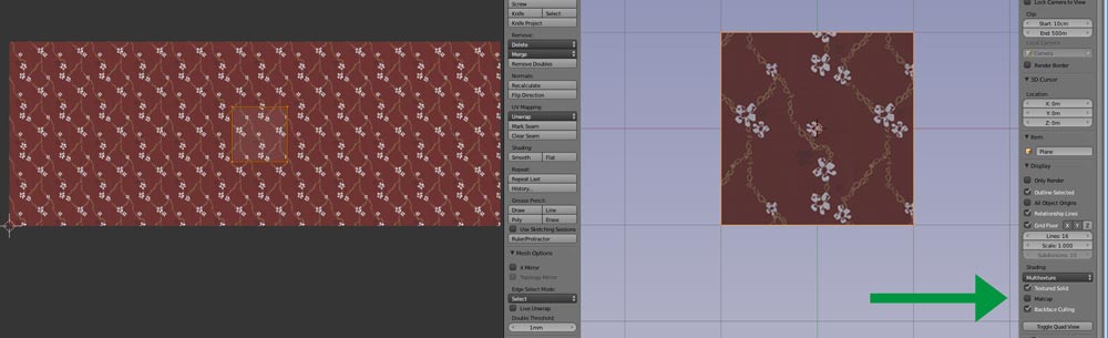

Hi Marten74, got your message but can´t reproduce your problem.
No matter what Blender version I take, if I load a non square image I also get a a non square unwrap.
Sreenshot is with 2.68a.
Cheers, mib.
Opensuse Leap 42.3/64 i5-3570K 16 GB
GTX 760 4 GB Driver: 430.31
Octane 3.08 Blender Octane
Marten74
Posts: 86
Joined: Sun Mar 11, 2012 2:49 pm
mib2berlin wrote:Hi Marten74, got your message but can´t reproduce your problem.
Cheers, mib.

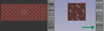

Hello!
Hmm, that is strange. The last image I posted was from Blender 2.68. Now I just installed 2.68a with the same result (see image).
The green arrow points out the shading options in (old) Blender that has been taken away from the BlenderOctane program. I figure that has something to do with why I can´t get a preview of what Image I apply in the UV editor. Let´s say you apply a generated UV grid in the UV-editor. How do you make it show in the 3D-view port? The only way I can figure out is to save the UV grid texture to disc, open it in an Octane texture node and plug it in to the material created for the plane. Then I can view it choosing the material option under shading options. If I have not missed something, I hope for tighter integration with octane plugin regarding this.
To get a non square projection from a square plane seems to me like a problem since this means that the texture will be distorted on the plane. The only way to get a non distorted texture from a non square texture would be to always have the plane in the exact same dimensions as the image. Some times that is what you want, but far from always. Do you see my point? I thought that maybe this is some kind of setting I have forgot about. I looked through the preferences trying to find something that could affect the projection from view function without luck.
Wonder if I´m alone about this? Interesting :shock:
Blender 2.68a, correct projection from view (according to me).

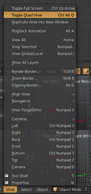

when in quad view I can't rotate the scene, and the top, side, front views are
blacked out.
Would it be possible in the future to be able to rotate the scene (Rendered), and
have the other views in wireframe, and editable?
No matter what, OR4B is simply a pleasure to use. :)

I've not fully understood what you mean. Anyway, Octane plugin is able to render only one view. It can't render few viewports in parallel...
myclay
Posts: 21
Joined: Wed Aug 14, 2013 8:53 am

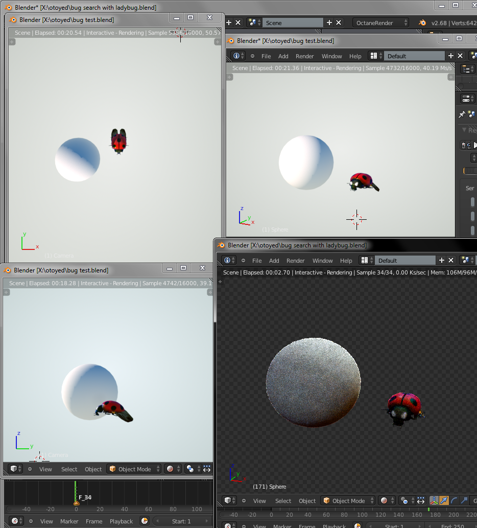

he used the toogle quad view ;)
given you can only render only one view , the problem is the following;
you can´t render the other views because quad view is treated as one view
(tested with the preview mode of Blender internal,Cycles)
Blender Internal has a short delay while using Shift + Z. but renders each one.
it boils down to this; there would be for making quad view for Octane to work
a way needed to render a preview right into the image editor of each view
at least for the 3 other views were your mouse is not hovering over.

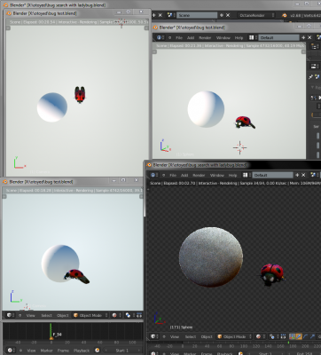

for now a not so good workflow, you could try this;
create Markers with shortcut M in the timeline
create 4 cameras which are placed like the Quad view ones
Bind each Camera to a Marker with Alt +B
render the 4 image animation.
and then you would need to set Blender up to somehow render them into the image editor of each view.
another way;
the renderpreview data is available after closing the Octane server;
open for example 4 Blender instances of the file (to mimic the Quad view)
I started trying it with linked Meshes which is the reason why my fourth blend is different
Render a preview -close the Octane server,
reopen renderserver
start render preview in another open Blend
and so on.

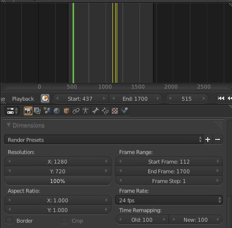

I managed to break the timeline with OpenGL rendering :shock: ,
could a Blender version upladed, with svn revision 59027 or higher?
due to old revision of Octane Blender version
https://projects.blender.org/tracker/? ... roup_id=9
