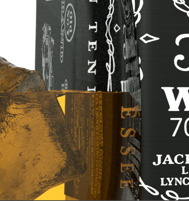

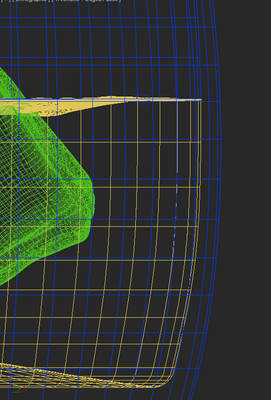

I adjusted a model to match (I think anyway) the required method for intersecting dielectrics, but I'm not getting the correct refractions. See the attached images - one shows the wire frame, with the liquid, liquid surface, and the glass all as separate objects - with normals point inward on the liquid, up on the surface, and out on the glass. But if you look at the quick render you can see the liquid is not refracting out to the edge of the glass (glass IOR is currently at 1.55).
The first model I tried had intersecting geometry (because originally the scene was in Vray). Has something changed in the way Octane handles intersections?

Seems something very specific to the angle of the camera. If I move it even a bit in any direction the liquid refracts properly. Maybe just an oddity of this file. Seems cool now anyway.
