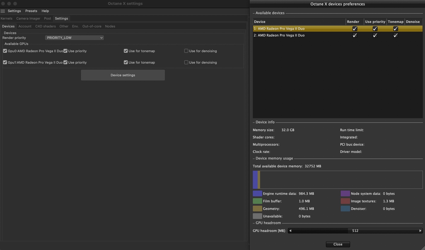

Hello,
MacPro (2019)
AMD Radeon Pro Vega II Duo
Cinema 4D R23
BigSur (11.2.3)
OctaneX-Enterprise-PR8
I have the impression that the GPUs are not fully exploited? is normal ?
thx ;)
cedric

Hi cedric,
please go to c4doctane Settings/Devices panel, press the Device Settings button, and share a complete screenshot of both panels, thanks.
Then share another screenshot similar to this:
How many monitors do you have, and at which GPU are connected?
ciao Beppe

Hi bepeg4d,
I have 3 monitors and this my Setting :

Hi Cedric,
thanks for the screenshot.
Yes, it is normal.
Since you have monitors connected, you have correctly enabled the Priority for both GPUs connected to monitors, and set it to LOW, to leave a portion of GPU power for handling system/monitors.
This is good to have when you are editing the scene.
You can set The Priority popup to HIGH when you need the full rendering power, and the machine is used for rendering only.
