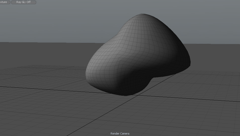

Is it possible to have support for Morph Influence changes without having to reload the scene?
Dino - can you pls send me a simple scene showing how you are using morph influences.

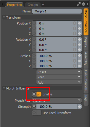

Thanks Paul, here's the scene just a sphere with a single morph map. Load the scene and activate Octane and you should see the sphere in the octane viewport.
Tick this checkbox:
The openGL preview will update the morph change but it doesn't show in the Octane render window until the scene is reloaded.
Hope this helps.
Dino.
This is fixed in the next release.
