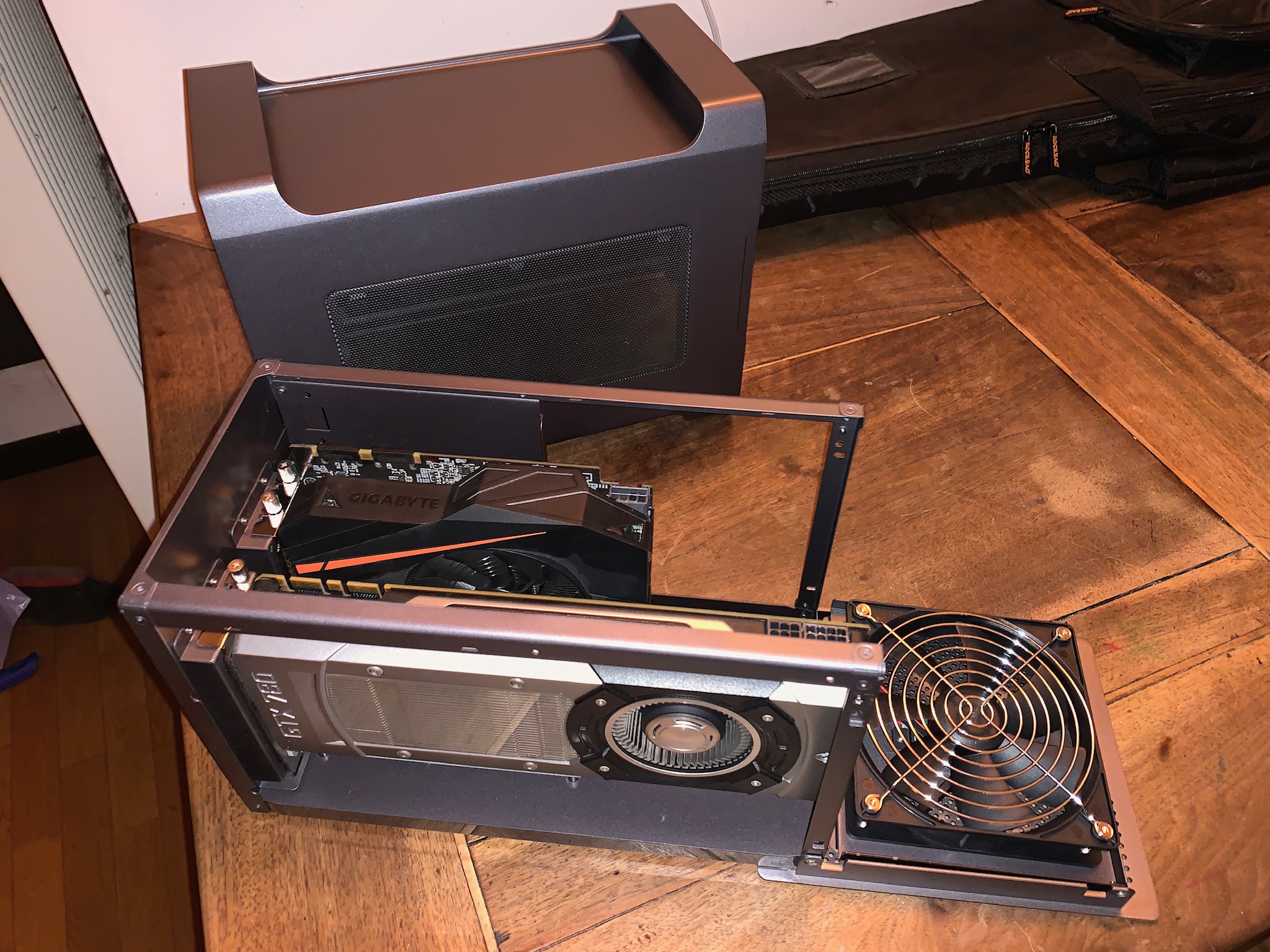

Can anyone recommend a solution for running 2 GPUs on a Macbook Pro 2019?
I already have a Razer eGPU with Radeon VII and it works great.
Considering daisy-chaining to another eGPU, but seems like an expensive route

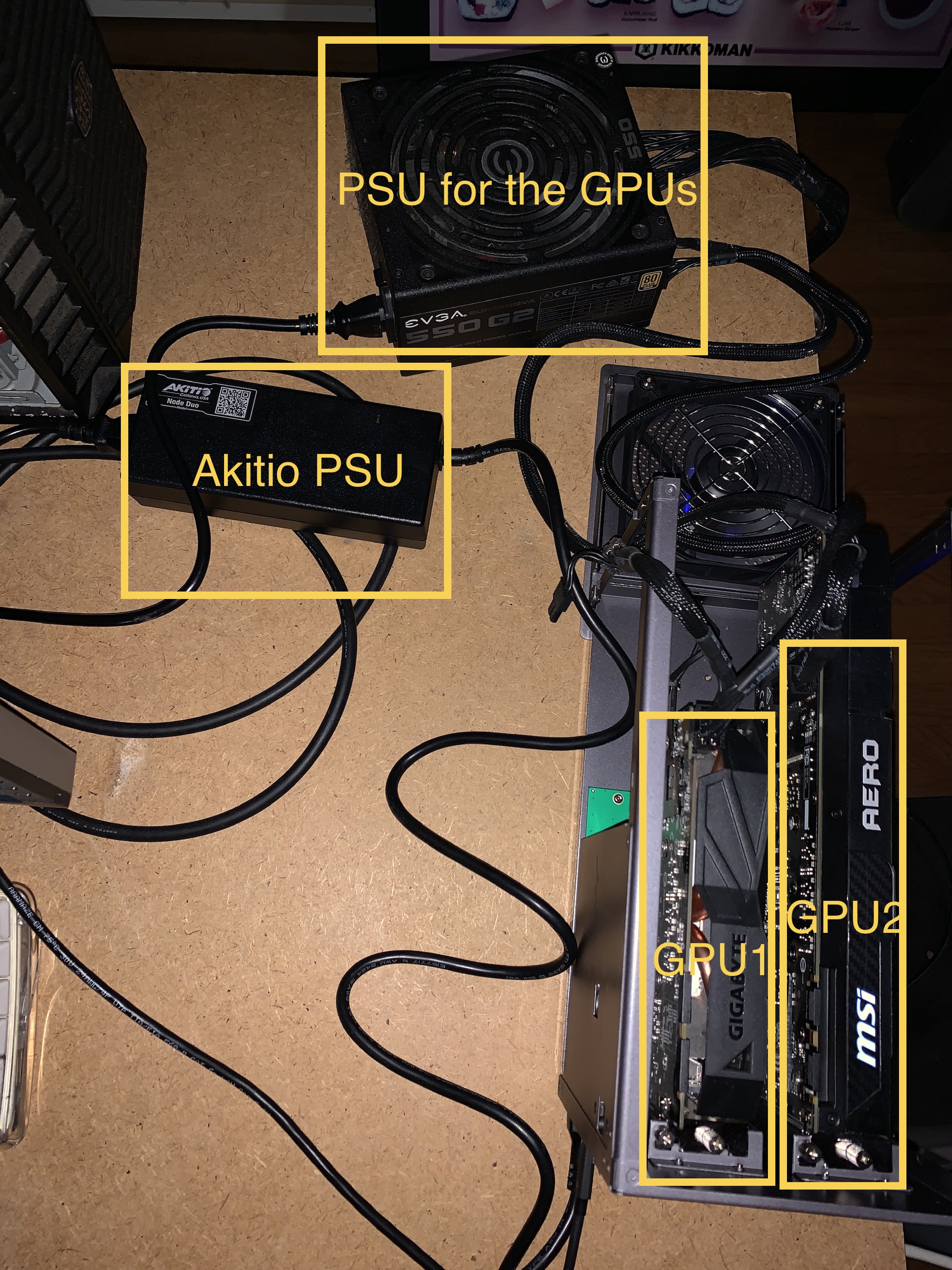

@ atoyuser1: I have a solution, but it is not very elegant :D
You need to take this guy here:
https://www.akitio.com/expansion/node-duo
Then remove the cover, and modify the fan position to be able to mount 2x full length GPUs:
Then use an external PSU for powering the GPUs:
It is quite a mess for the cables, but it works great, and super silent :D

atoyuser1
Posts: 212
Joined: Sat May 02, 2020 1:10 pm
bepeg4d wrote:@ Weezer: Great :D
ciao Beppe
Wow, thanks!
