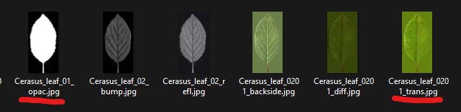

I forgot to add before examples of the opacity and transmission PBR tags - here are examples of filenames from popular vendors :

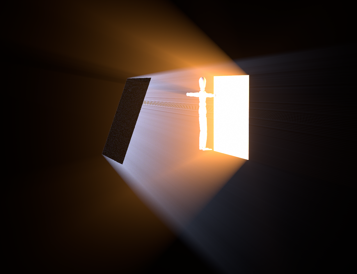

Hello,
I get these artifacts from post volume lights:
https://www.dropbox.com/scl/fi/2w32reee ... ro099&dl=0
I love new octane btw! Packed with new things!
One q: going forward all lights should set to analytics I guess?
Thanks!
