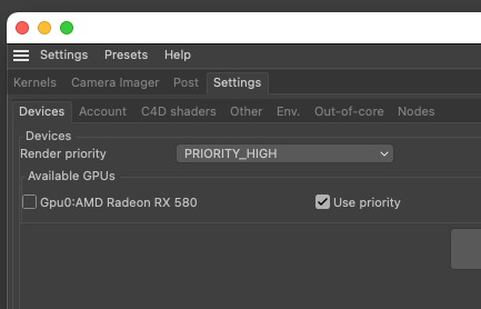

With PR14 i cannot render anymore with my setup. Is PR14 exclusively aimed at Monterey? I am with C4D R21 under latest Big Sur and an AMD RX 580. It seems to be loaded as a plugin, and it recognizes my video card, AMD RX 580 as a device, but if checked, the setting will be ignored after switching out of the settings tab. See screenshot.

3dworks wrote:With PR14 i cannot render anymore with my setup. Is PR14 exclusively aimed at Monterey? I am with C4D R21 under latest Big Sur and an AMD RX 580. It seems to be loaded as a plugin, and it recognizes my video card, AMD RX 580 as a device, but if checked, the setting will be ignored after switching out of the settings tab. See screenshot.
PR14 is for Monterey(OSX 12.0). It's mentioned in PR4 Standalone post.

@3dworks: please note that AMD 580 is a Polaris GPU, but AMD Polaris and Intel GPUs are not supported anymore in new OctaneX PR12/13 for macOS 12 Monterey - there were some Apple Metal driver related issues.
So you need to stay with Big Sur and OctaneX PR11.
