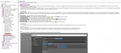

1-Read manual to see how to use it! SEE PICTUREthodosplay998 wrote:Mate, is that ok?
Basic thing, Material ID. It changes from one color to another in one sequence.
And it's not a Standalone SDK problem, because it works fine in Standalone.
I had also experience when using Layer ID and some of objects just dissapearing in the sequence on the last frames!\
Also Render Queue just crashes Cinema 4D.
Your OpenGL alpha on materials makes objects fully invisible in viewport even when no opacity is used inside of it(and it was working fine in 3.08-3.09)!!!!
Do something with it, it's a basic things that needs to be working! Why do i pay for my suffer?
I experiencing same problems from 3.06 C4D Octane Render.
2-It's not a simple issue as you can think! C4D's custom material support is not very well and limited. Just don't use opacity for opengl previews if that's not working well. We did our best! You don't have to talk like this!

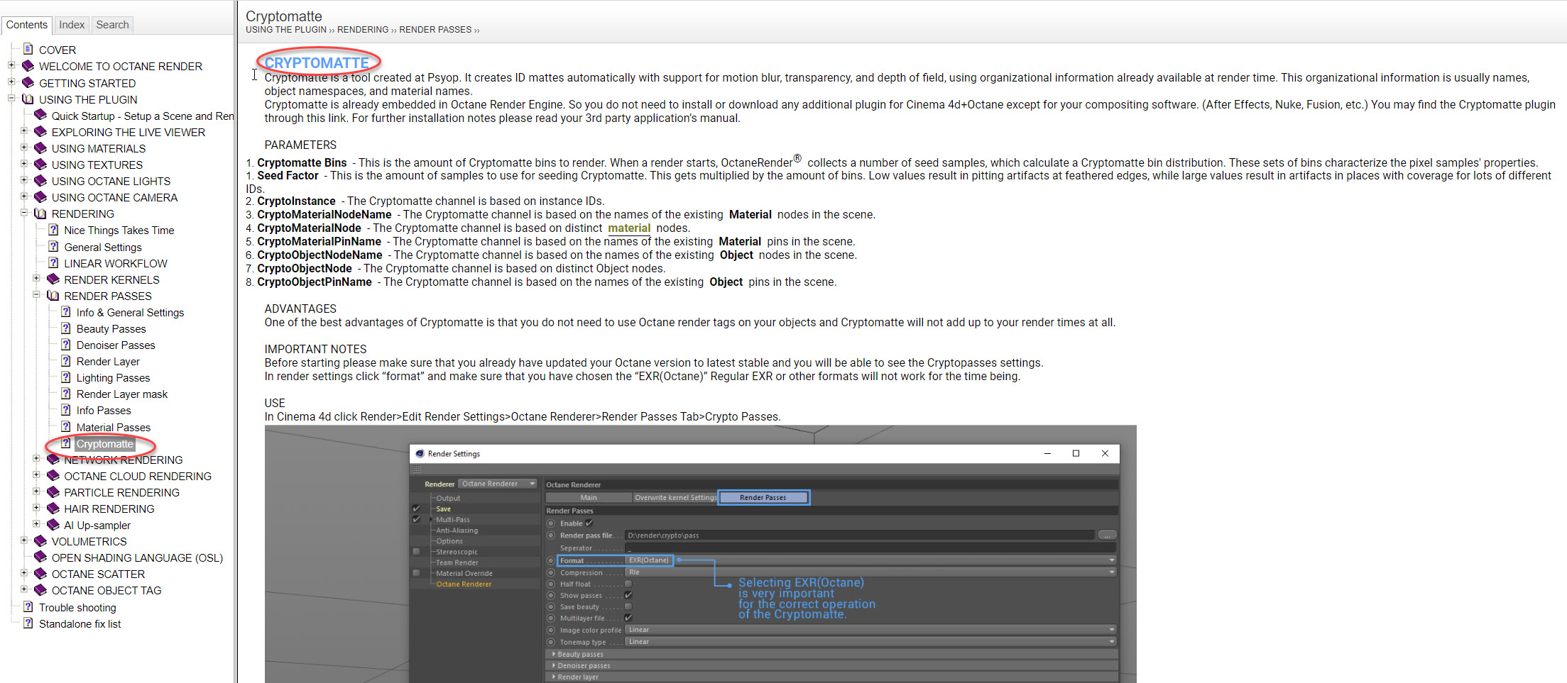

material id will change because of ID changes, use material names instead. See picture to find the link from c4d manual.thodosplay998 wrote: BUT! Why is Material ID works fine when rendering an image from Standalone, but not from c4d? And render Layer issues?
If you are reffering to manual, please, send some links, didn't see any of Material ID.

It's not fault of plugin(me). Probably SA has an internal ID to keep same, plugins doesn't. Keep to use "material name" instead of it, and lost your frustation.thodosplay998 wrote: To be fair this situation is giving me a frustration. Materials are the same, same scene, same render sequence. 74 frames are with one color, 75 and further are another. Standalone is rendering without changes, how is it possible? What do i get wrong?
