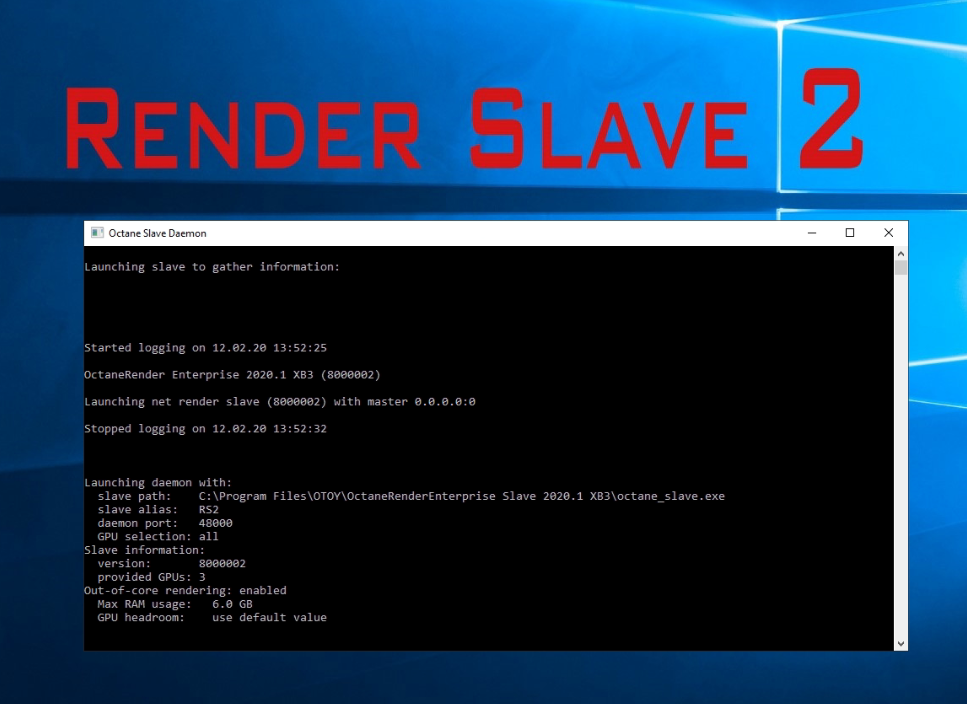

Does XB3 support network rendering (enterprise license) ? i can't see my render slaves from standalone + win_slave installed on renderslave ?
Shows nothing on list when i enable render-slave and yet my batch file seems fine/in order when started.

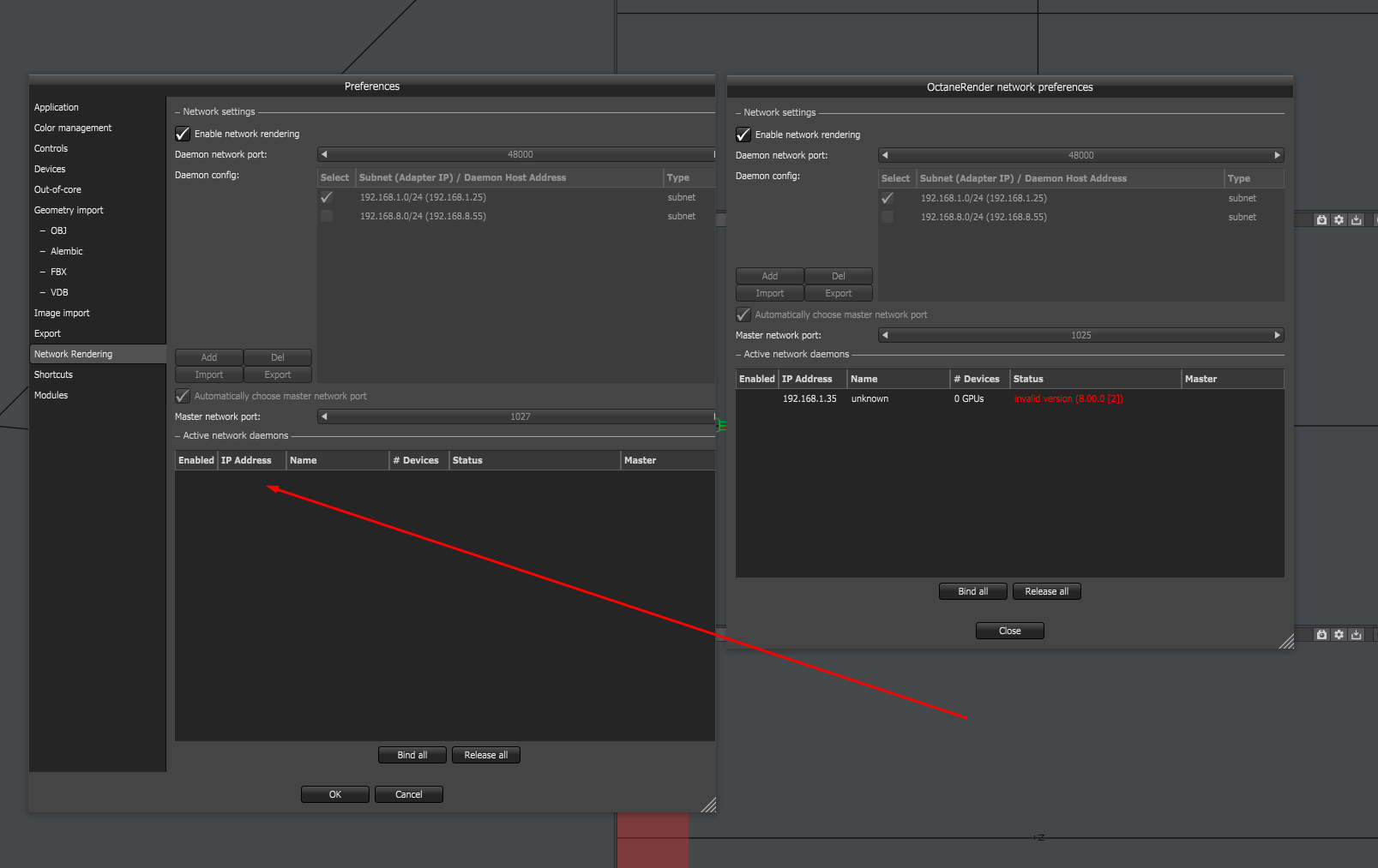

I have BAT file working and if i open network render from Plugin side (LightWave with 2019.1.5 octane - right window) i see my slave (yes it reports that slave has wrong version but main thing is that it sees it), if i open network rendering panel from Standalone i see nothing in my slave list ? That way i'm sure my *.bat works and it's correct but for some reason Standalone see nothing on that list ?
Here is screengrabs

please re-read what i typed :). I'm not trying to make plugin work. that is fine i can find and use plugin with 2019.1.5 work fine,also with 2020 bu standalone is not seeing 2020.xb3 slave. that is problem here :)

if the master standalone is already right version, it should be working already, because through the plugin you can see the slave means the slave side is correct already,
just try restart the standalone at the master side, if it still not working , try reinstall the standalone at the master side...

Tried all that already and no go. That is why i asked DEVs here does XB3 network render even work in standalone since it is not seeing anything on network. And i installed slave and standalone on renderslave anx rebooted both multiple times and still nothing.
