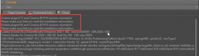

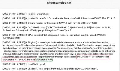

Ok. i, clear c4doctanelog and delete all other plugs, turn on all log flags in octane.
This is all that remains in the file after the application crashes after it is closed.
file from C:\Users\divasoft\AppData\Roaming\MAXON\Cinema 4D R19_BFE04C39
https://yadi.sk/d/ecOzdCBMwwuHjQ

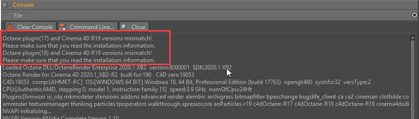

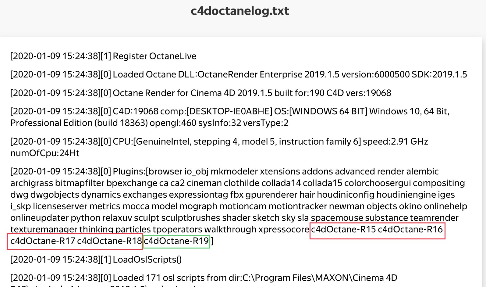

Ok Beppeg warn me, you have a wrong install.
Yes, it worked. Thank you so much for your advice.
